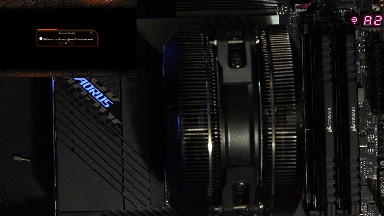

I also seem to recall Buildzoid complaining that DDR4 overclocking with gigabyte Z690 motherboards being a massive issue.
Try this video for info but I'm at work and don't have the time/can't be asked to watch it again
