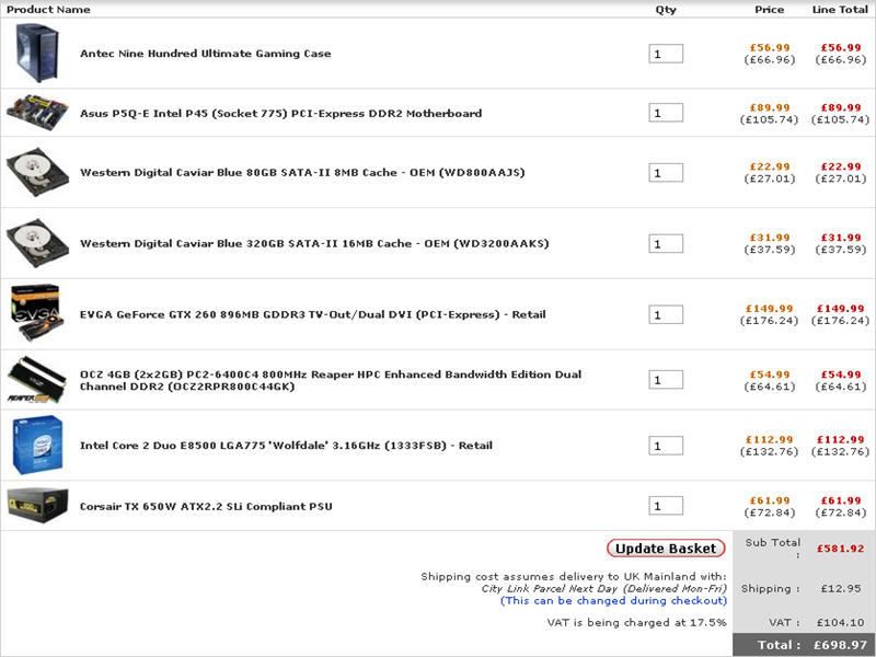

This is my current computer.
http://i3.photobucket.com/albums/y98/alphaomega16/Comp222.jpg
