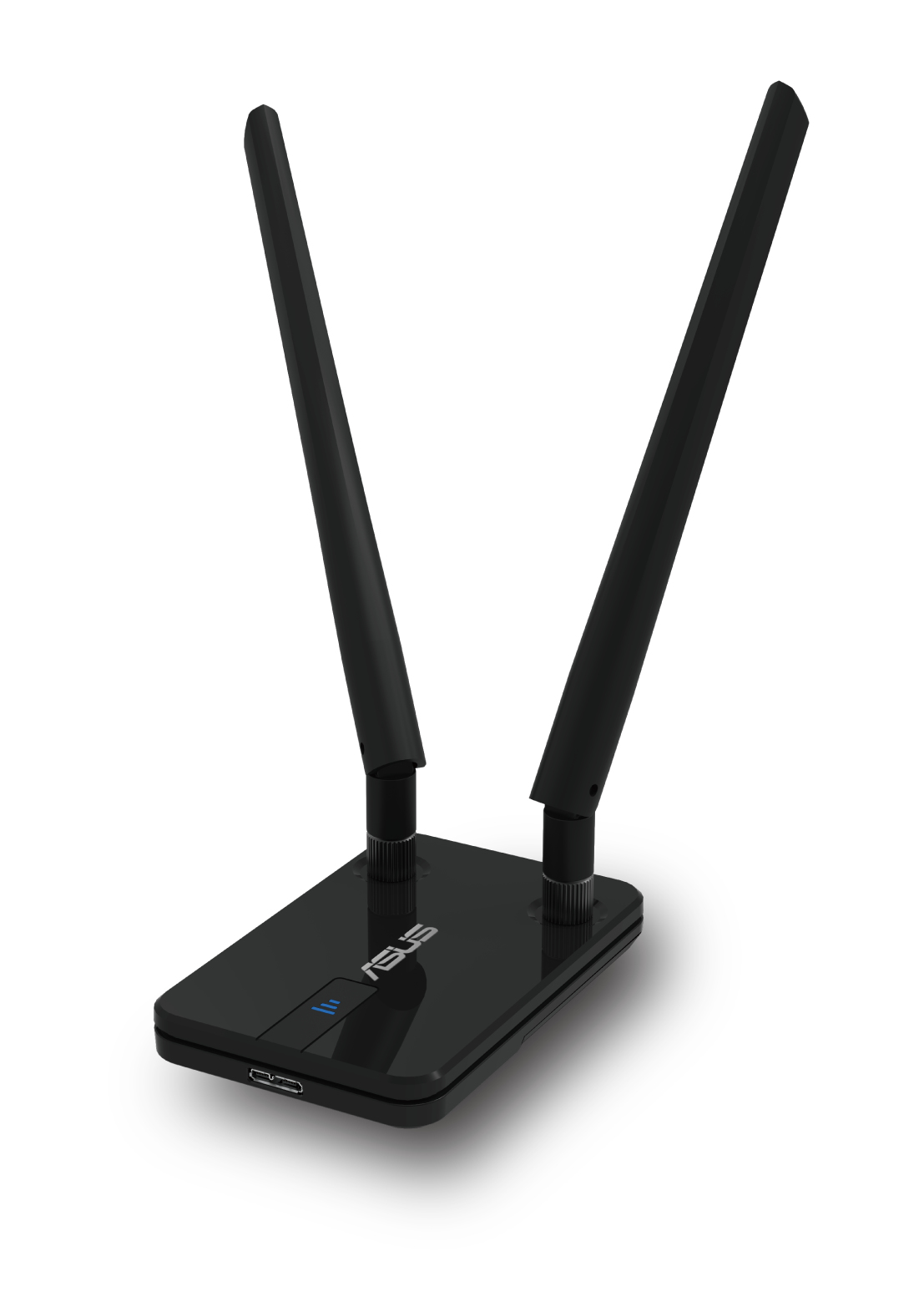

If you definitely won't go for PCIe then the Asus USB linked below is at least a decent compromise, it has 2 antenna, is a decent form factor and comes with a USB Cable so you can position it.
