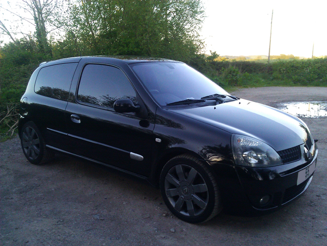

Mine are probably at the limit for the front. Was purchased like this. Not yet been pulled over since having it.
