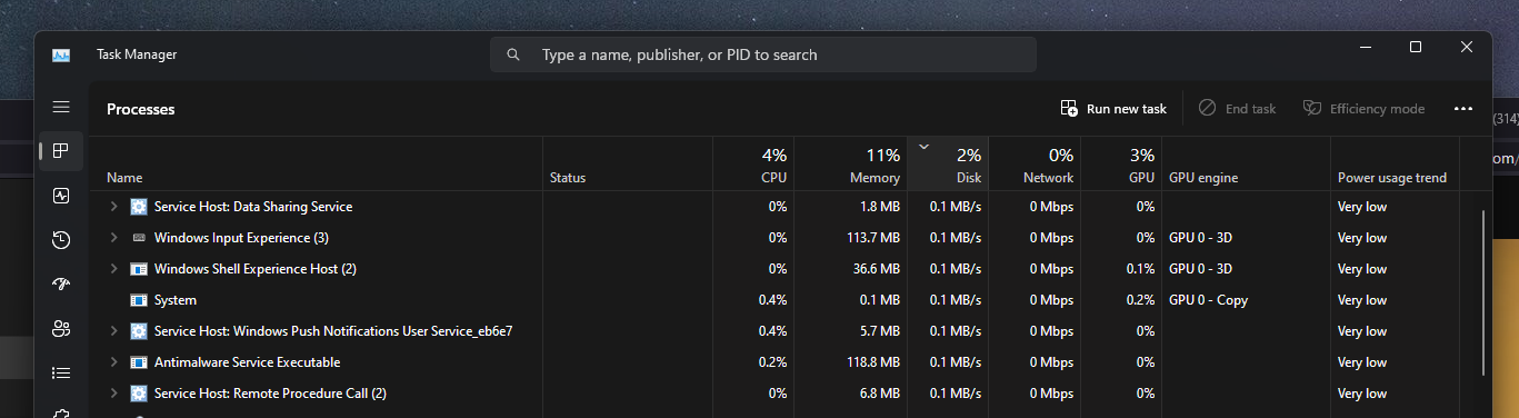

The disk monitor tab doesn't show you much other than /activity/ It's the main task manager tab that is important here, you can sort by disk usage, which is exactly what is needed here.
You can sort by disk activity in resource monitor as well, then select the process to see what actual files are involved which can help to narrow down where the activity is coming from.
Not sure where you think I'm talking about but you can sort by process, read speed, write speed, total, etc etc in res mon. It's way better than task manager.

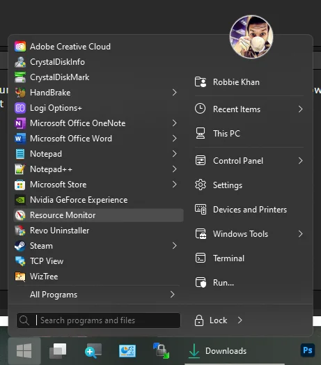

Oh I thought you were referring to the Disk tab in task manager whch shows basic resources, not Resource Monitor itself which is outside of task manager and its own tool (perfmon.exe). I think task manager used to have a link to perfmon, but as of now, can't see any option to launch it, just start > perfmon, then pin it for quick access. I have it in the start menu for easy access when needed :p
