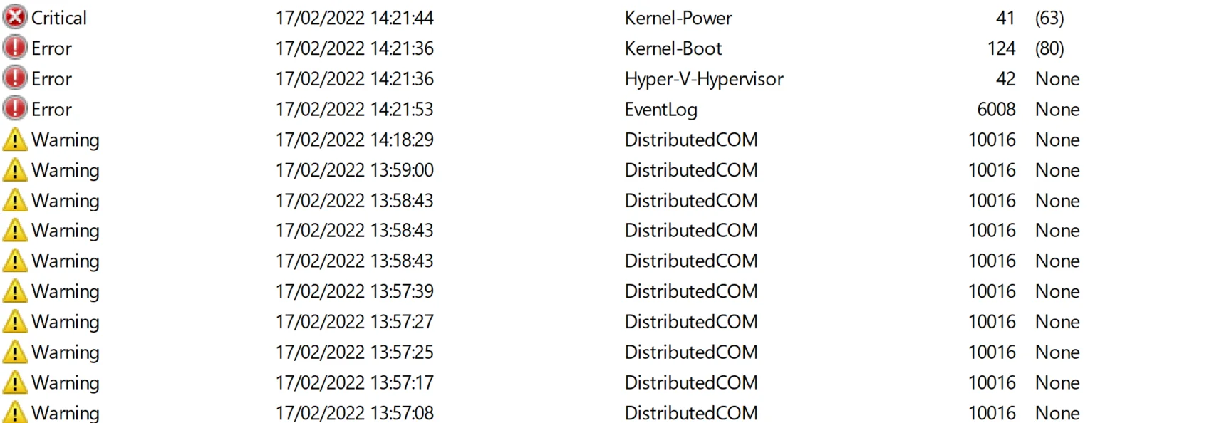

No, nothing around the time of the install when the crash happens. Previously it was complaining about Hyper V:
So, as I no longer use virtualisation, I removed Hyper V from Windows Features, feeling smug. Actually no, feeling tentative! Then
It crashed again.
Not crashed since, so far.

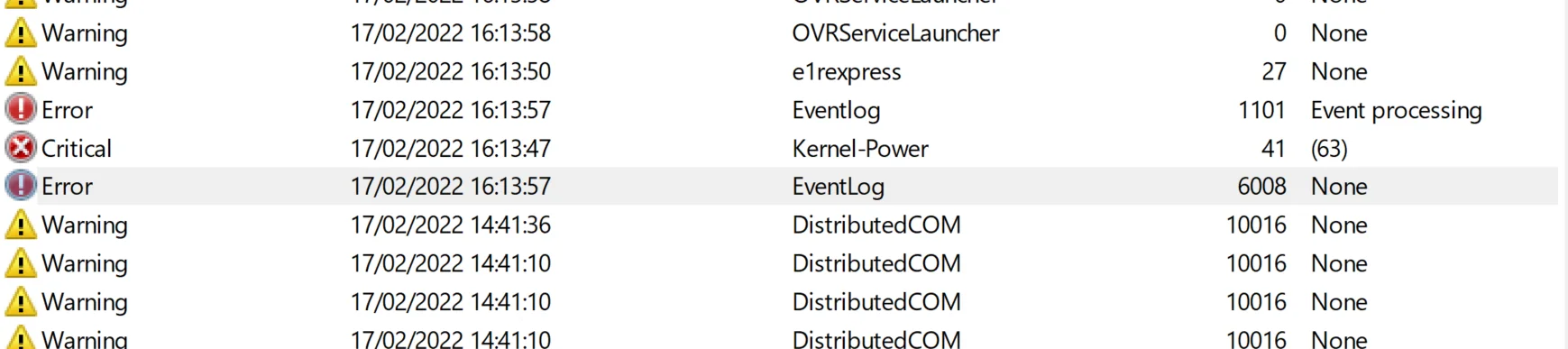

It crashed again.

Thank you very much for posting that. I had watched this clip and tried exactly what was suggested when it was first published. I disabled C states, it was called something slightly different on my board IIRC. I was thrilled when I first saw this clip and thought it might just solve. Alas no. I am getting to the end of my tether with it and is why I started this thread now. The issue started the first day. Looking through event viewer, it usually happens around 3-4 times, then is stable until I have to reboot, then it starts again. I usually leave it on for days and days so it doesn't happen every day.
