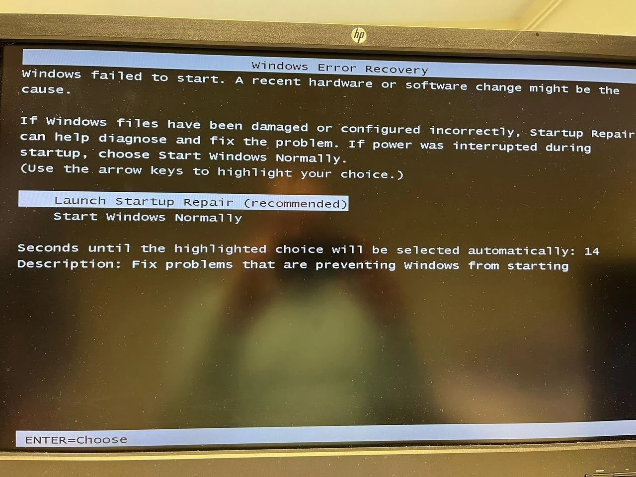

any suggestions go get this PC out of this recovery loop. Its a windows 7 PC in my dads office with some legacey software on it. I probably wont get a chance to physcially look at it today, but if anyone has some suggestions before i go googling.

Start normally, and it just reboots to same screen, click repair goes to black screen and no further. No Recent hardware or software changes. ( i have been warning them for the last 5 years that this day would come!) PC is an Athlon II X3 450. its now actually considered retro!
You could try forcing it into the boot options screen by hitting F8 just after the BIOS finishes loading but if it's not doing that on its own the likelihood of getting the safe mode, last known good, menu screen to pop-up is slim. Next best thing will be to stick the Windows 7 install media into the machine (i assume a CD) so it can find the files it needs to start the recovery environment.
If it's stuck looping that screen it's probably some sort of file corruption, could be fixed by a simple 'chdsk' or maybe a drive failure.
Unless something has changed software wise recently like updated drivers it is more likely a hardware issue like failing SSD/HDD or failing RAM or CPU no longer stable. If a lot older system possible the PSU is no longer providing stable power or capacitors on the motherboard are on their way out.
I bought a 240gb SSD , i'm first going to try and clone the old drive with macrium reflect. then see if i can run fixes etc on the cloned drive, I have spare RAM, PSU, GPUs. If its the motherboard then its end of the line, unless i can find the exact one on fleaybay as the software may deactivate

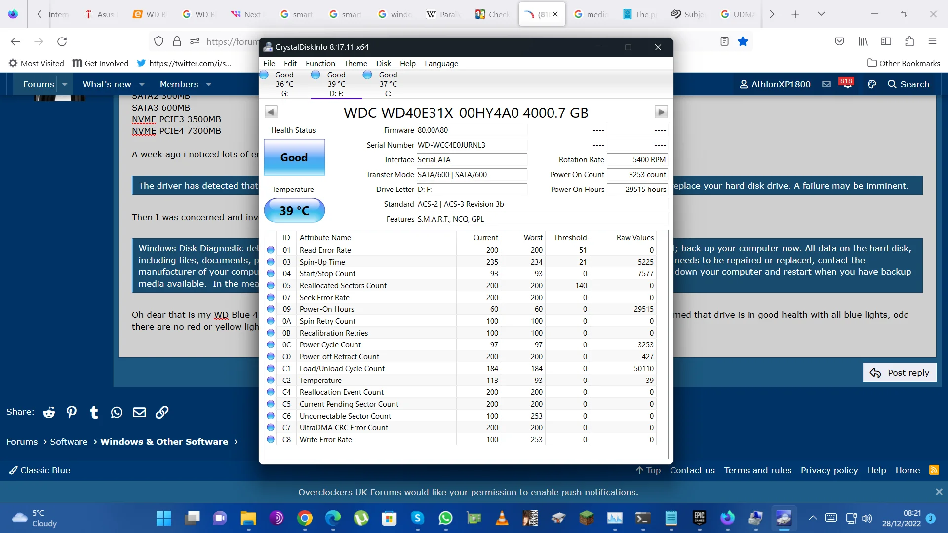

2 weeks ago i noticed lots of errors in Event Viewer's System occured every few days:
The driver has detected that device \Device\Harddisk1\DR1 has predicted that it will fail. Immediately back up your data and replace your hard disk drive. A failure may be imminent.
Then I was concerned and investigated deeply found a critical warning on 5 Dec and then found the first critical warning on 21 Sept:
Windows Disk Diagnostic detected a S.M.A.R.T. fault on disk WDC WD40E31X-00HY4A0 (volumes D:\;F:\). This disk might fail; back up your computer now. All data on the hard disk, including files, documents, pictures, programs, and settings might be lost if your hard disk fails. To determine if the hard disk needs to be repaired or replaced, contact the manufacturer of your computer. If you can't back up (for example, you have no CDs or other backup media), you should shut down your computer and restart when you have backup media available. In the meantime, do not save any critical files to this disk.
Oh dear that is my WD Blue 4TB SSHD bought in 2015 took 7 years to reached SMART failure but strange CrystalDiskInfo confirmed that drive is in good health with all blue lights, odd there are no red or yellow lights on Reallocated Sectors Count, Current Pending Sector Count and Uncorrectable Sector Count. I now remembered on 21 Sept after booted PC saw a SMART warning message on D: F: then pressed F1 to continue and logged in desktop saw SMART hard drive failure warning notification and ran CrystalDiskInfo and it confirmed WDC WD40E31X-00HY4A0 is in good health and tried opened File Explorer to checked download folder, transfer folders, ran game, ran CrystalDiskMark benchmark fine and defrag successfully. Then I dismissed SMART warning as false positive.

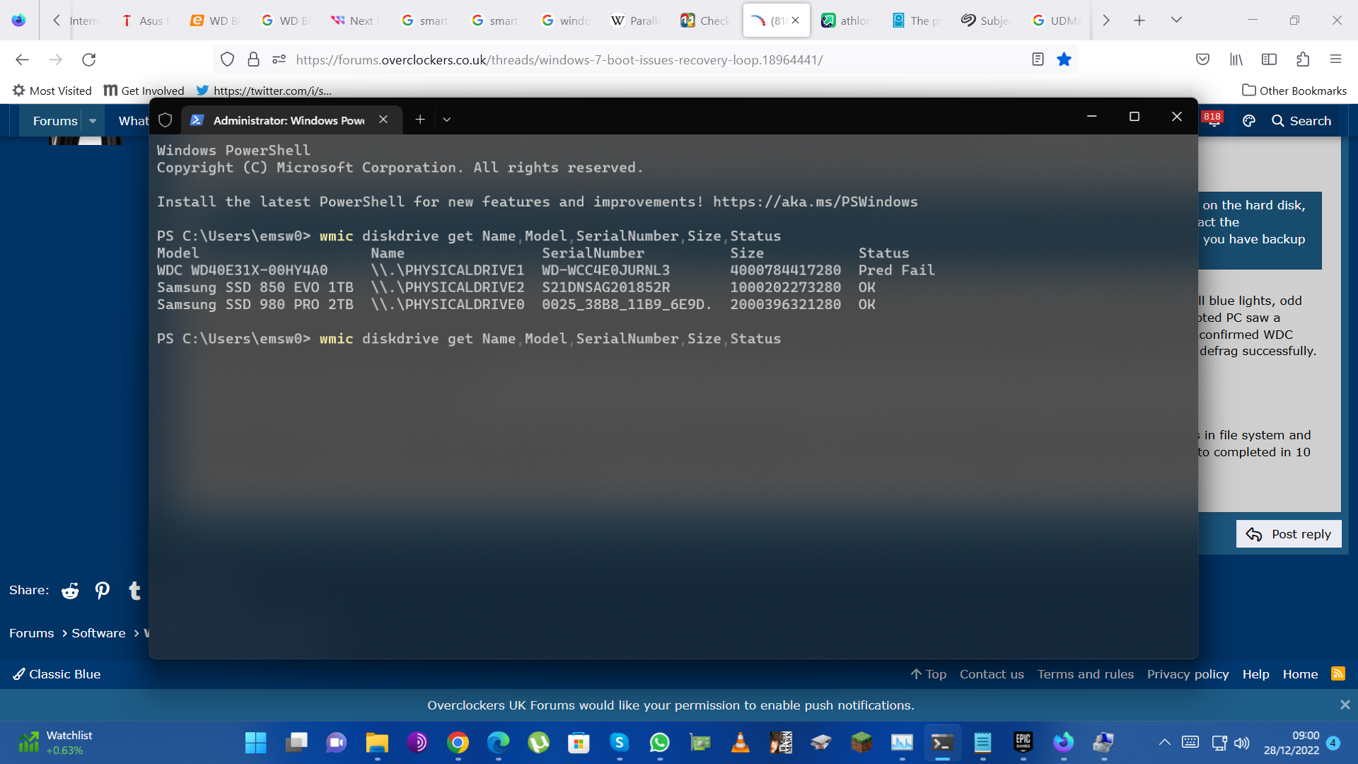

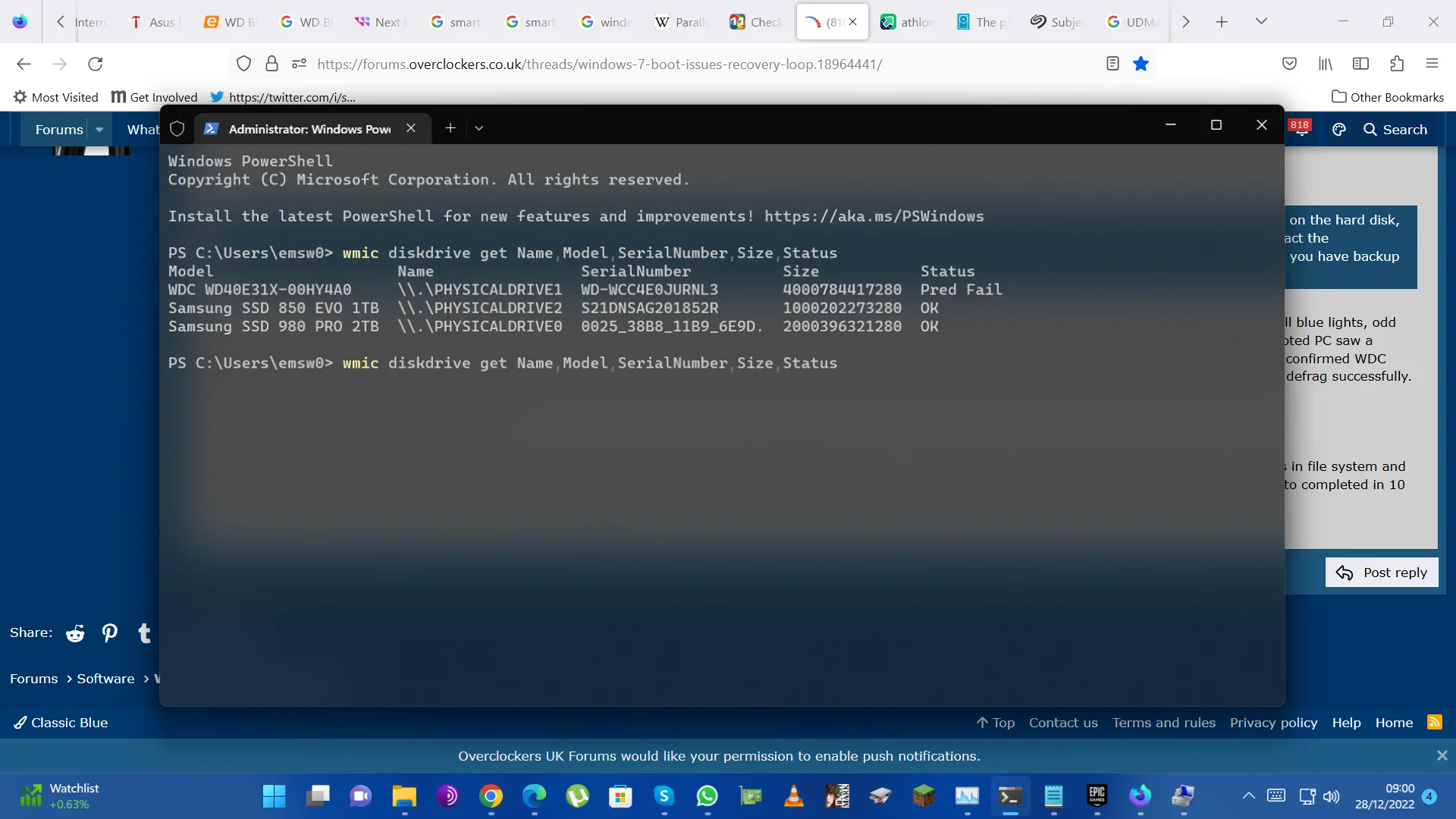

I tried to defrag D: and F: but it took forever then I cancelled it and opened Terminal ran chkdsk /f /r on D: and F: after 6 hours later on each partitions it found errors in file system and successfully repaired. The drive seemed fine after played a game from D: and downloaded many files to D:. After that I tried ran defrag on D: and it was worked able to completed in 10 mins. Then I googled found a way to confirm SMART status of hard drives.
WMIC Diskdrive finally confirmed my 4TB WD SSHD will fail soon, so I will need a new 4TB drive, lucky I found WD BLACK 4TB PCIE4 SSD SN850X at bargain price and ordered now plus I will get 5% cashback. :) I will use Macrium Reflect to disk clone 4TB WD SSHD to WD BLACK 4TB PCIE4 SSD and retire 4TB WD SSHD as file storage offline.
