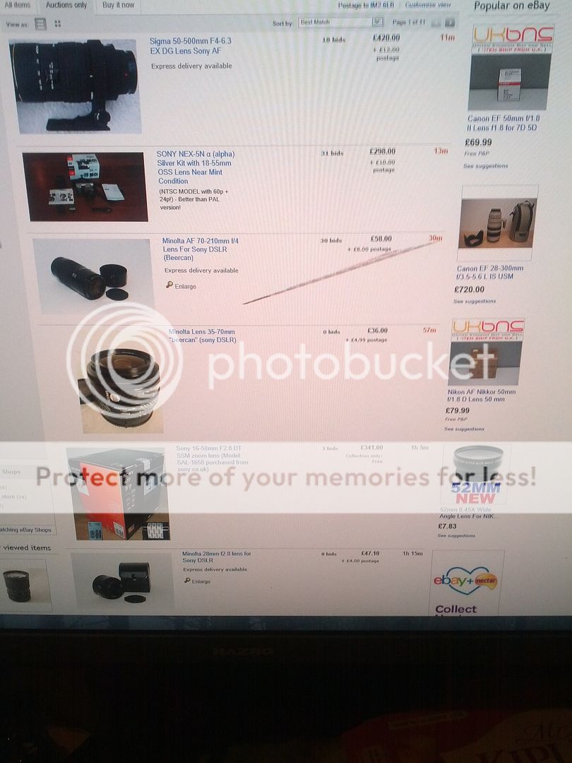

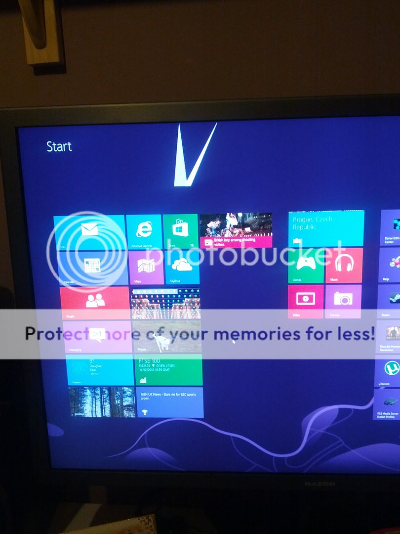

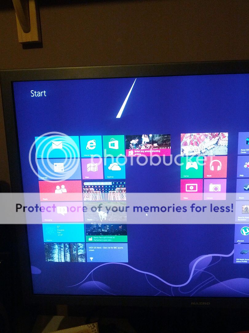

Just put windows 8 my PC and now get the following lines on desktop and metro, but only when I move the mouse or the use IE on desktop mode, so odd.
http://i712.photobucket.com/albums/ww122/crezzlin/IMG_20121216_225113.jpg
http://i712.photobucket.com/albums/ww122/crezzlin/IMG_20121216_225121.jpg
http://i712.photobucket.com/albums/ww122/crezzlin/IMG_20121216_225122.jpg
Has anyone seen this before, could be my GPU, but it works fine under load in any game etc, just has this problem on desktop/metro, but not in any apps or programs. Thanks

The PC has been sat for 2 months as its a second computer I used for Photography, I have just put in a new ssd and then windows8, from what I can remember I had no problems in the past with it.. but as you have said the driver maybe the problem, I will try a different win8 driver to see if it fixes it, I've never seen a pc do this apart from a GPU fail but then It wouldn't act like this. Thanks
have you checked the pins on the cable? unplug and check then re seat it, and see if any difference, just an idea, you probable have already tried it, but only a thought, next one to try is uninstall in safe more the drivers for the card and re boot, then let the o/s pick a default setup or run in standard vga mode and see if you get the same errors, if yes your monitor may be going, if not then a card ir driver error, btw what res are you using, the default one that windows picked and recommend for you monitor or your own?
That looks like graphics corruption. The last time I had that and 3 weeks later my PC was actively BSOD'ing, it got worse and worse until it wouldn't boot. Had to replace my graphics card. The RAM chips on it just died. Wasn't overclocked, it was a high quality XFX passively cooled card that had been working fine for about 4 years.
