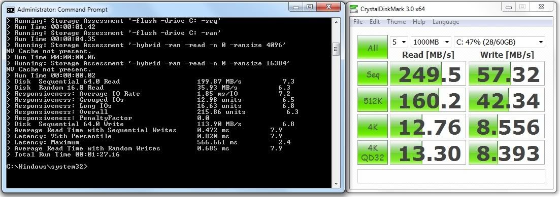

I've just tried running the dos benchmark and crystal and here are my results and I'd be very interested in any feedback on it:
My dos benckmark results seems much worse than yours. What SSD was you using when running that benchmark?
Looking at the crystal benchmark results, Seq Read seems fine at 249.5 MB/s but doesn't my Seq Write appear too low at only 57.32 MB/s?

Thanks. I have just tried as you have suggested and results have come back as DisableDeleteNotify = 0 so it looks does look like trim is enabled.
