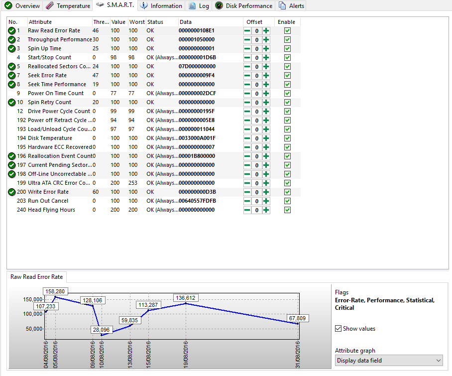

I have checked smart all are reported just fine and i am already on a fresh install.
General overview of drive health.
Below is a more detailed look at the drives.
120gb kingston SSD with windows on it
2TB 7,200 rpm drive for shadowplay
1DMy9
80gb 5,400 for virtual machine
5TBwd red Games drive
5TBwd red Media drive,
5TBwd red misc/software backups
