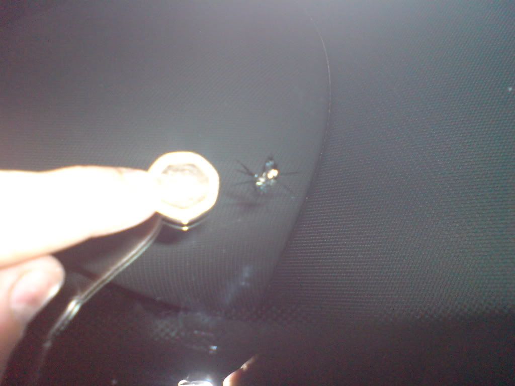

This is it with a 20p as reference, not quite as big as I'd first thought but I'm still ****** off about it. Wish I'd been able to get the taxi's plate :(
you don't need a replacement screen for that, looks like a stone chip
someone like autoglass will fix that no problem

IIRC it has to be smaller than 10mm, else it can't be repaired anyway.
One of my colleagues had a big stone put a big chip in his windscreen causing it to be a MOT failure, as it was larger than 10mm across. He had to have a new screen fitted as a result.
/edit
If the chip is in the drivers' line of sight and over 10mm, then it's an MOT fail. Not sure what the maximum repairable chip is.

If you are getting it repaired, book it in quick. The repair relies on the chip not getting filled with crap otherwise the resin they insert will not "take".
I left it too long and now i need a new windscreen.
Yeah do it asap before it continues to crack.

Went down to the car this morning to pop it down the road to Halfords to get AutoGlass to fix it. Cracked 1/3 the way across the screen.
Admiral have given me free windscreen cover, so someone from AutoGlass is going to be ringing me tomorrow to sort out a replacement. £70 excess and won't count as a claim, which is better than I thought but I'm now without a car until it's sorted. Damn :(
