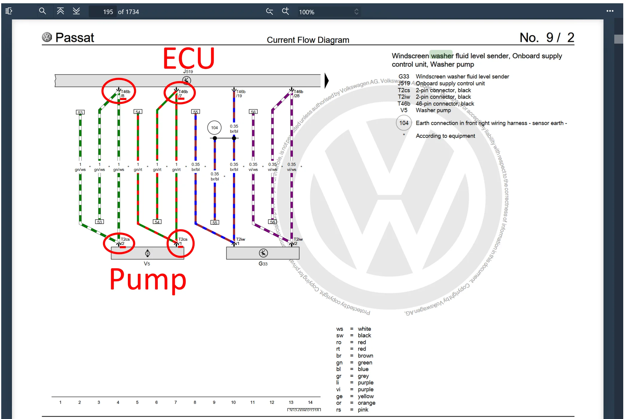

There's no additional relays etc in the way, just a control signal from the stalk to the cars ECU, then voltage/earth from the ECU to Washer Pump via the fusebox and lastly a supply voltage/earth supplied to the ECU. You've narrowed down the stalk (wipers move), you've said the fuse "looks" good (confirming its Fuse 40 which is 20A that you checked the rear washer jets also don't work) and the supply/earth to the ECU should be good or there would be lots more issues which just leaves the supply/earth from the ECU all of which leaves the supply to the washer or a blockage.
On the washer pump plug there are just two pins - Pin 1 is Voltage and pin 2 is earth - if you want to check that each is working OK whereas on the ECU it looks like the voltage/earth are on Plug B pins 7 & 8 if there's nothing at the pump. If there is voltage at the pump (which you've replaced) you know its most likely a blockage somewhere.
Electrical Diagram (spoilered due to size) -
