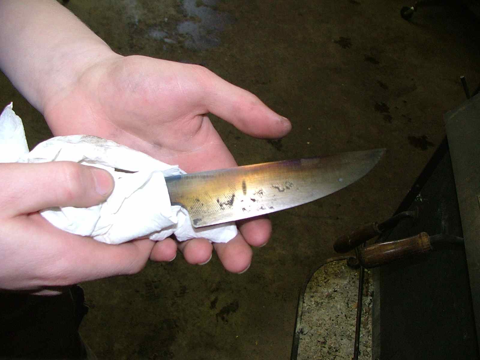

Not sure if it is just me, but it sounds like the metal itself has reacted in the heat , as opposed to dirt on the racks, like the colour change steels typically go through when tempered, search "temper colours"
does it look like this ?

That's what I had feared, it's £90 for replacement racks.

Now that is a useful link. It seems to say that the temperature when my oven is in a cleaning cycle is not hot enough to cause oxidation. It also says that it can be removed by hydrochloric acid. That means I think it's worth a three quid punt - but I'm not expecting a miracle. It's reasonable to think though that if it's able to have 10 year old racks coming up as new then it'll be some powerful stuff in it.
