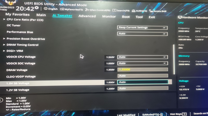

I tested just the 2 sticks and they ran at 2400mhz.
I then tested the 1 stick and it ran at 3200mhz
Then i noticed DOCP was off, so i enable it.
The 2 sticks then ran at 3000mhz.
I didn't bother testing the 1 stick again.
So now with the 3 sticks back in, i am now running at 3000mhz
1 stick of ram only
2 sticks with DOCP OFF
2 sticks with DOCP ON
And finally all 3 sticks with DOCP ON
I suspect when you enabled DOCP it put the DRAM voltage to 1.35v, which is fine for the TEAMGROUP sticks, but strictly speaking an overvolt for the Crucial.
You are correct, is it ok to carry on in your opinion?
The PC will probably be obsolete before the ram dies, but if you don't care about the performance (e.g. this is an office PC and you don't play games, or only very light games) then I'd turn off DOCP.
Thanks again for all your help.
I will probably leave it on for now as i do play games on it.
