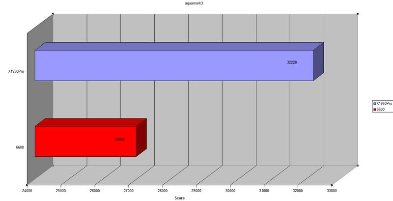

here is the chart showing my score on 3dmark03
here is the chart showing my score on 3dmark05
here is the chart showing my score on 3dmark06
here is the chart showing my score on aquamark3
as you can see a nice allround improvment
