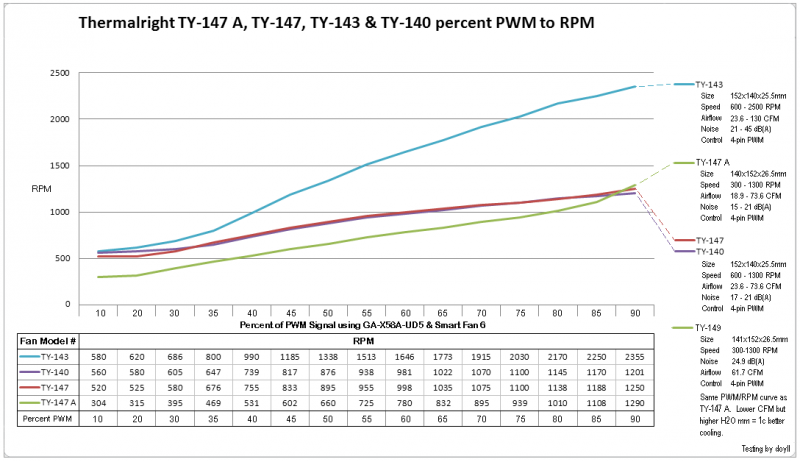

What new boy said. All PWM splitters be they cable 'Y' or hubs only use the PWM signal from PWM header .. and this signal strength spec as well as the fan PWM receiver specs determine how much signal is available as well as how much signal is required for fan. THis can mean 2-4 fans or 8-15 fans. To the best of my knowledge there are no PWM signal boosters available.

PWM signal is only a signal lead to the fan's PCB that triggers 12v power pulses from the 12v power lead to fan. To add complexity to this, the PWM "signal" is not a normal pulsing signal. That said, if the signal is not being recognized by fan PCB, the fan will run at full speed.
As a general rule, all fans of the same rpm range on same PWM signal will run the same speed. But this is not always true. Some fan PWM PCBs are programed with different signal to 12v pulse rates. For example, TY-147A and TY-147 are same fan with different PCB curves. Result is with same PWM signal, TY-147A rpm curve is different from TY-147 rpm curve.

I've ran as many as 15 fans on single PWM signal. I also know people with Corsair PWM fans that had trouble running 3 or 4 fans. I've found as a general rule of thumb, 8 fans will rarely be a problem, but from 10-16 it's playing the PWM lottery as if the will or will not work as intended. ;)
