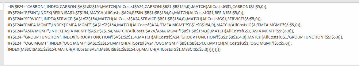

I'm no stranger to a long confusing looking formula in Excel and sometimes it can take me ages to work out what i've actually done.
I was recently sent a file from someone who'd used "Alt-Enter" in the formula bar to lay out the formula to be more "code like"
I thought it was handy and made a note to try and use it in practise.
It's turned this confusing shambles of text from this
to this, which i'm sure you can agree is much easier on the eye!
You are absolutely right. Clarity helps a lot in programming. That said, it still looks horrible. Can you not set up a name range with CARBON, RESIN, etc, then test for membership and use one of INDEX, MATCH, HLOOKUP, or VLOOKUP as appropriate to return the result? At first glance, you might need to use the INDIRECT function to use the name returned as the sheet name.
And make those ranges clearer with names.
Actually, you might consider unwinding the IF statement, calculating all eight results, then choosing the appropriate one? It might actually be faster. My brother runs spreadsheets many, many gigabytes in size and has found this to be faster because of Excel's excellent multi-threading capabilities (except for VBA, which is single-threaded). Excel will recalculate separate sheets on separate cores.
It is, until you start using named ranges and it becomes more of a hindrance than a help. My tip would be to keep it simple and split those uber complicated formulas across multiple cells and do this:
