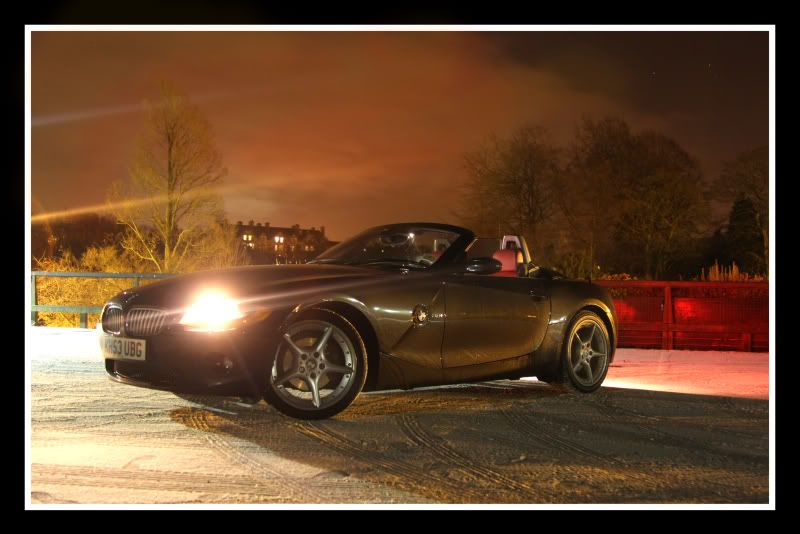

I had mine down when it was snowing last year at night so it must have been bitterly cold
then.

Can't imagine it being more than 3 degrees there. It was freezing and the roads were covered in snow.
