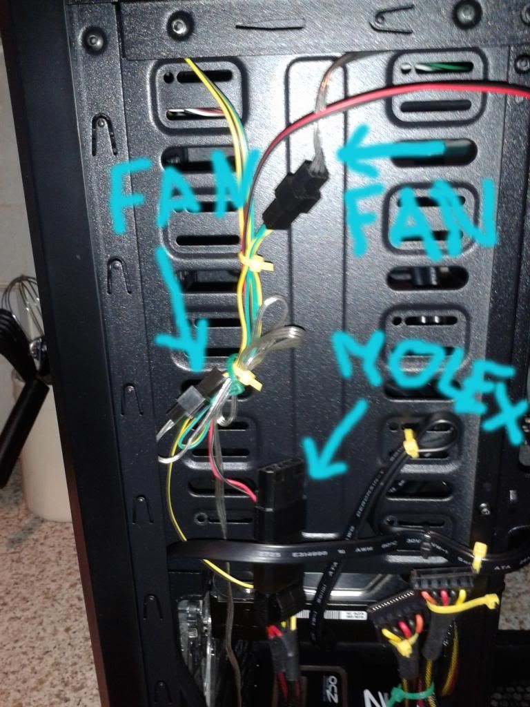

Just got this today and it's got the fan controller on the front but i'm struggling to find where to plug the adapter in, anyone help me out?
If I understand you correctly, your case fans will plug into 2 or 3 fan sockets ( 3 pin ), which are already connected to the fan controller. The rear exhaust however, is connected to a psu molex connector, which I find quiet enough considering its at full 12volts all the time.

So if i plug in just the fan controller all the fans will work?
here's a pic of mine,
So, you have to plug your case fans into the two fan connectors, and also the psu molex connector, to power the fan controller and temps read out.
Hope this helps
