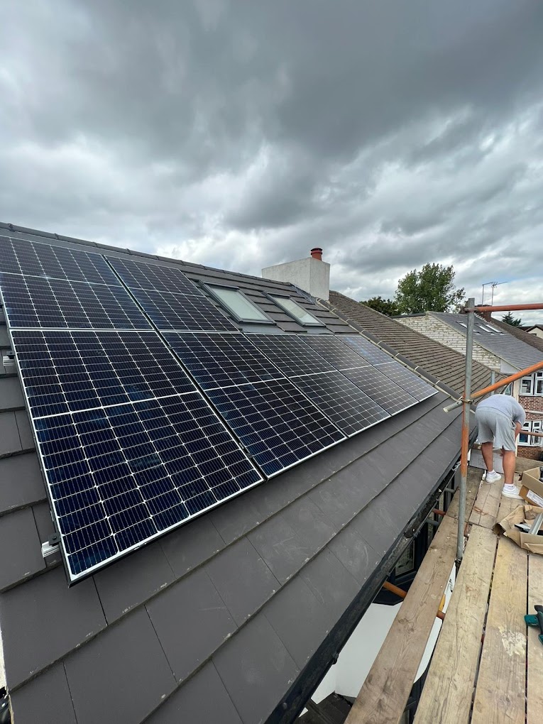

Any pictures? How close to the flat roof edge? How is it fixed down? When was it installed, has it been through any winter storms yet?
thank you for asking, I don't know how to send pics here but both the flat roof and pitched are 300mm close to the edge. (also looks like because it is close to the edge, it is might be causing verge damage during storms on pitched roof.)
the flat roof panels are not fixed down.
It's up for two winters and there were storms.
but looking at complexity, what do you think?

Sounds like the flat roof is fine then if its been through 2 winters already, so can leave that alone? Bird guard mesh needs fitting around the pitched install to stop the pigeons? Damage to the verge, obviously needs repairing and then working out why it became damaged and do something to stop that. Really need pics to advise further.
If its been up for 2 winters, whats the problem with the installer now losing MCS certification?

I am after fixing the verge but it might be damaged because of the pitched roof Solar PV is very close to the edge and due to vibration, it might be damaging the verge or during installations.
I am worried that the flat roof panels can damage the roof if it is not stable and that's too much to pay for.
The installer lost MCS accreditations after I signed the contract and installation so didn't produce the MCS certification.
I don't MCS certificate for the installation.

I am worried about further costs as not gain much from installation and no point in spending more when the return is low.
Please advise.

Nothing wrong with those installs……mine are fitted closer to the edge than those without issue. They been up 2yrs you said with no issues.
So whats the problem???
