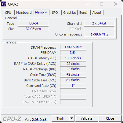

Here are my timings btw:

Thanks for the detailed response. So your saying that the 980ti only scores that much higher than more modern GPU's because of the memory having better timings? So that means that it would be also more worthwhile to invest in faster ram if you are drawcall limited in modded Skyrim / Fallout 4? Compared to investing into a more power GPU I mean.
Well, the 980 Ti is Nvidia so even with the same timings as, for example, @Robert896r1 it is unlikely that your Radeon 6800 would score the same. However, if the 980 Ti was the only competition then at resolutions and with mods the experience of the 6800 would be better. Now against an Nvidia card with enough grunt and VRAM like a 3090 etc., the Radeon driver overhead (for DX11 anyhow, for DX12 AMD's overheads are better than Nvidia's) would kick in.
The top scorers here aren't just those running a high RAM clock but more those who have good RAM which is able to handle good timing (for which the RAM modules, motherboard and CPU are a factor).
But basically, this test running at 480P is mostly in spite of the GPU. The only major factor GPU wise is the GPU vendor with Nvidia's DX11 driver stack having a very noticeable advantage versus AMD's DX11 driver stack - at least in these games.
On the other hand, the Radeon 6800 has 16GB of VRAM and there are Skyrim Wabbajack modlists which state that even for 1440P they want 12GB VRAM so as long as the 16GB 6800 is cheaper than a 12/16/24GB Nvidia card (used 3090s are probably the cheapest) then it is good value for playing modded FO4/Skyrim.

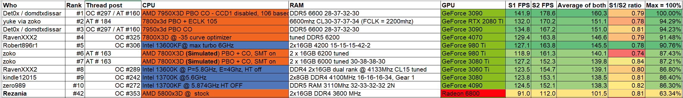

Unsure, but here is the full chart of all results:
Most like a 7800X3D @ stock is the best bet at this although for Starfield the 3D cache seems mostly wasted - no guarantee that those changes will ever make it back to FO4 though.

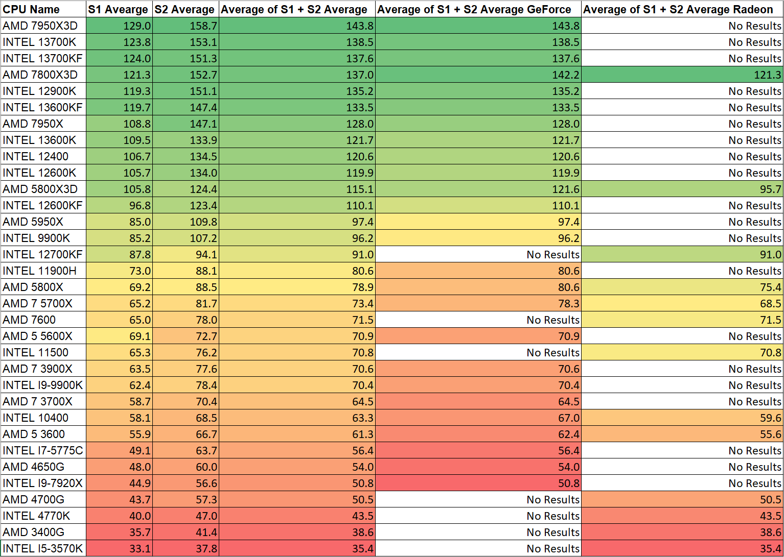

Decided to add two others columns to the results: CPU Name and GPU make so I could use some AVERAGEIFS, here is the results:
Yes, I know this ignores all the hard work of people with their tuned memory etc. which might get some people the wrong idea - as someone who doesn't tune their memory (or whose RAM or motherboard are poor) will get below the average - but it is a far easier to digest thing.
Might be an even easier thing to digest if I took out the 10-20 of the worst performers.
