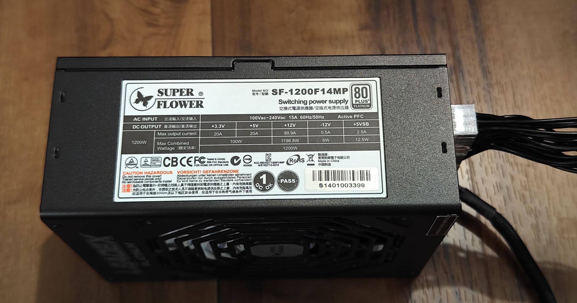

How is it possible to tell the age of a PSU?
Can you tell the age of mine?
