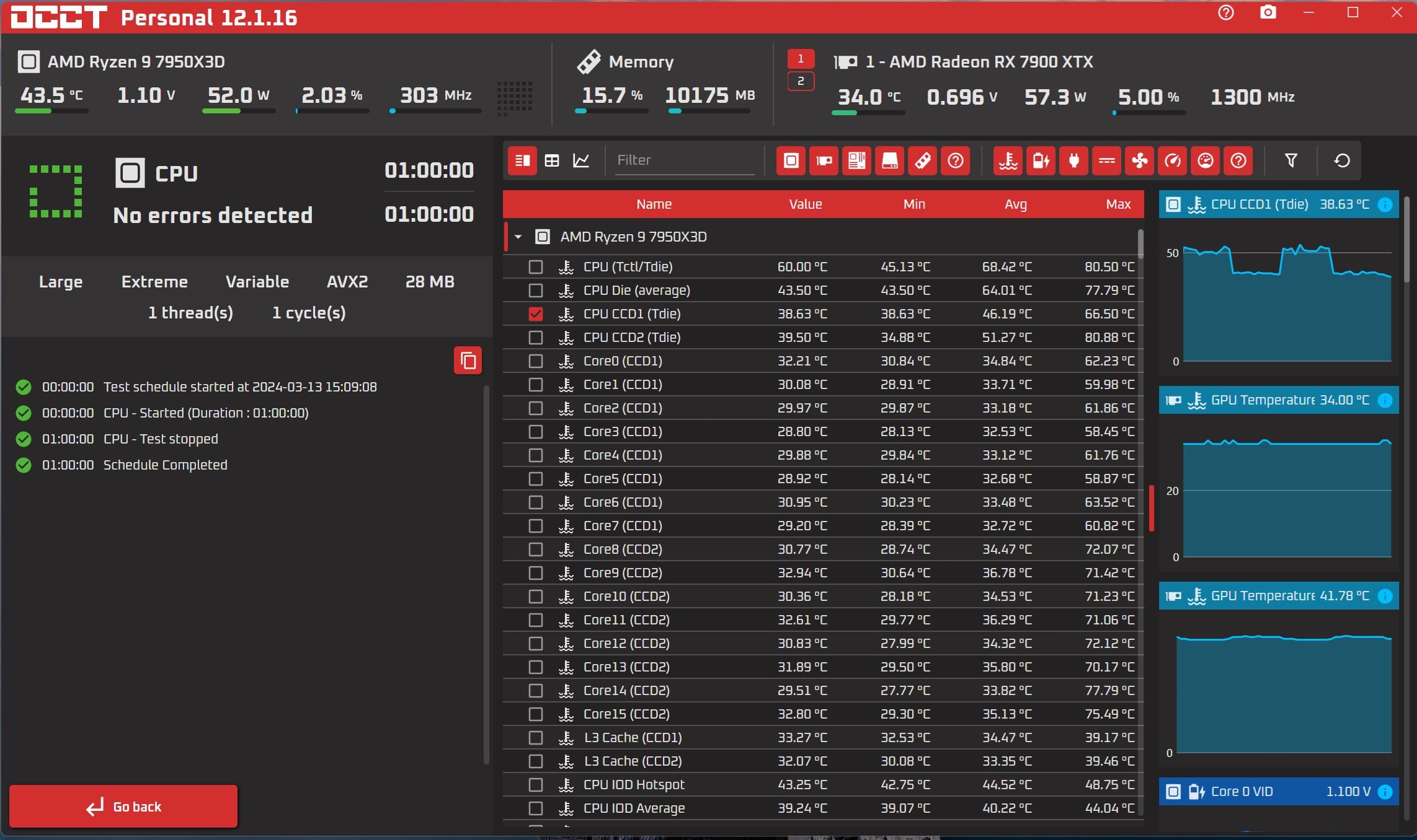

FWIW mine does it too in OCCT doesn’t bother me as my machine appears to be stable otherwise.
Well I've got to the bottom of it guys. I did a fresh install of Windows 11 and installed all motherboard drivers, chipset etc. Now my machine passes the OCCT Extreme Variable Large Test on Corecycler. Left it running for the full hour and it passed with no errors.

They all should and mine does at stock after a fresh Windows 11 install. It didn't on my 2.5 year old install which started out life on a different motherboard and CPU. The only reason why I did a fresh install was because Geekbench V6 was showing a much lower score than normal 13000 as opposed to 20000 which I now get.
I only tested OCCT again for the hell of it and it passed. In future when changing motherboards I will do a fresh install, it only took me about 4 hours to reinstall everything which is not to bad if only doing every few years.
Never realised that transferring an old Windows install to new hardware would cause this issues. But the advice has always been, do a fresh install after changing hardware.
