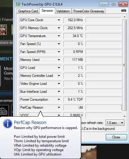

You can see in gpu-z the reason
Power limit is obvious move the slider in AB or flash your card if it's locked at 109% or whatever.
Thrm is obvious your cards to close or past the target temp (around 80c and boost scales back)
Vrel = cards got no more volts to give up the core voltage.
I dunno about others but msi is bios locked to a safe limit but you can still up it using afterburner to that limit (only gave me 30mhz more boost though but might give a higher oc manually)
Vop = no idea not enough psu?
Util just means the card isn't getting enough load from the game/benchmark
