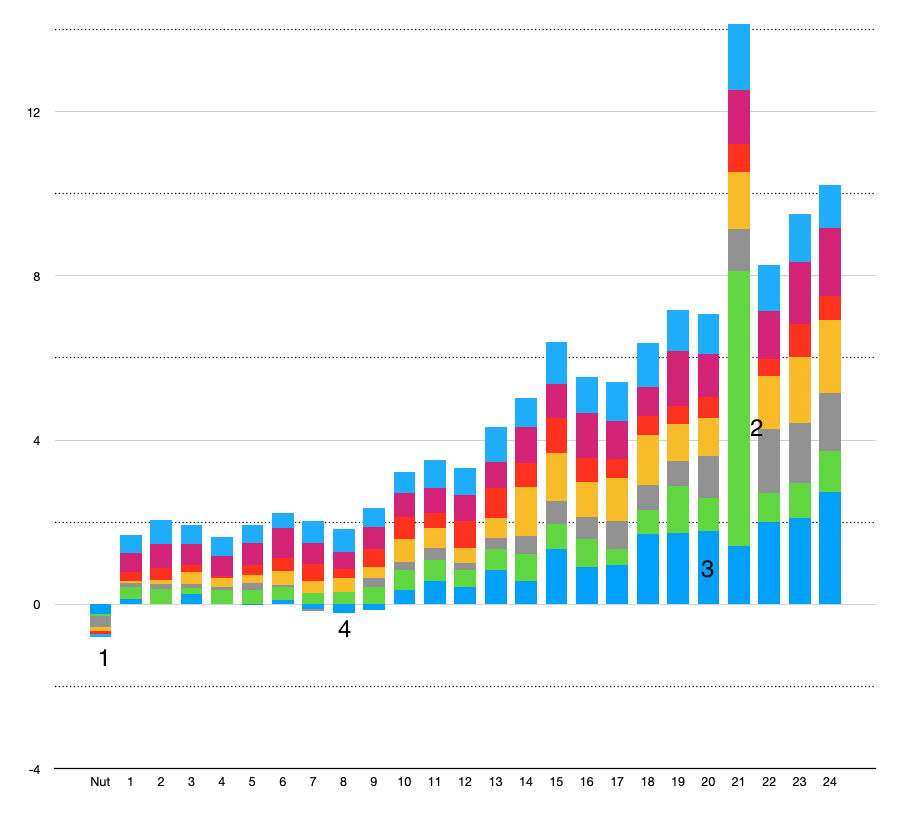

So I measured each string fret frequency and calculated each string fret frequency mathematically, the graph below is the % error deviation:
Colour Key:
Bottom Blue = Low B string
Grey = Low E sting
Yellow = A Sting
Red/Orange = D string
Purple = G string
Upper Blue = High B string
Green = High E string
Note that simply pushing harder will change the frequency in the order of a few Hz given they're jumbo stainless steel frets so small error may be due to measurement.
The points on the graph that I need to look at:
1. The Nut - this is showing a big jump between the nut and the first fret that then has an impact through the rest of the frets.
2. That's my duff high-E string upper fret due to a couple of lifting frets.
3. This looks like my B string being a little erroneous up the frets.
4. This small so it may be a measurement error.
Frets in even 12 temperament go sharp up the fretboard but there's obviously a couple of issues.
First that Nut needs attention - ideally we can remove fret 1 error entirely and that would remove from the rest of the fretboard.
Edit: easy test for observation #1 is to tune the first fret, ignoring the open string. Sure enough the rest of the fretboard has less error. Although the Low B still has issues, which may be a bridge issue. Barred chords sound nicer too.
I think this points to the nut being too far away from fret 1, so shortening the fret length.
Edit edit: I tuned the guitar to fret 1 .. sounds a lot better and a large number of frets are bang on in frequency. So I think that will be the next improvement.

Sorted the issue with the sharpness.. turns out my intonation was intimated for 12th.. but not for the fretboard.. hence it was turning the entire fretboard sharp although it was 'intonated'.
13 Jan 2003
23,667
Now I'm happy with the intonation - ignoring my lifted frets that need attention - the intonation error (measured Hz vs the calculated intended Hz at each fret) is at maximum 0.28%. Which is very low :)

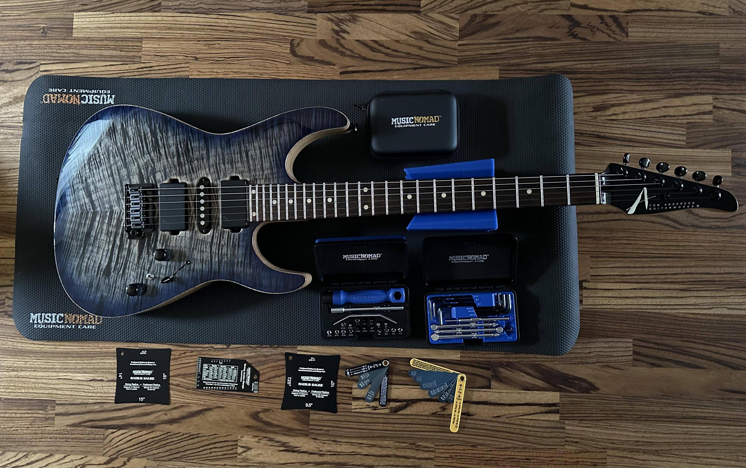

Bought myself a set of fancy ‘music nomad’ set-up tools, having swapped in some 8s for an easy playing experience. I really like the fold out metal bit for ensuring the truss rod is set right, as trying to calculate whether a gap is “around 0.6” is impossible for the naked eye.
It’s a very lovely set but Jesus, how much did these pieces of plastic and metal cost?! Around £200 :eek:
… I expect you could do it much cheaper with alternatives but the reviews seemed to suggest that the tools etc. are really good and well considered… so I just went for it.
The pic I took for this.. Imgur wouldn’t work at the time!
