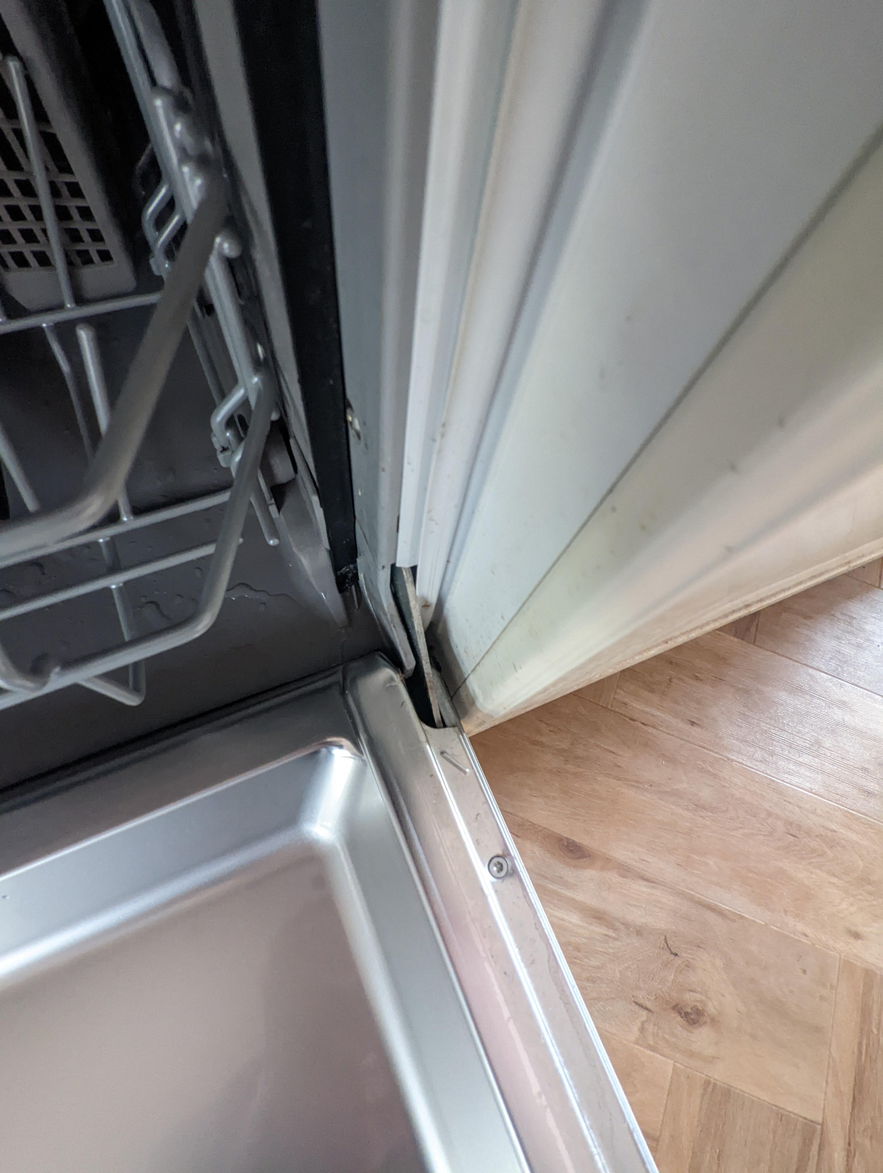

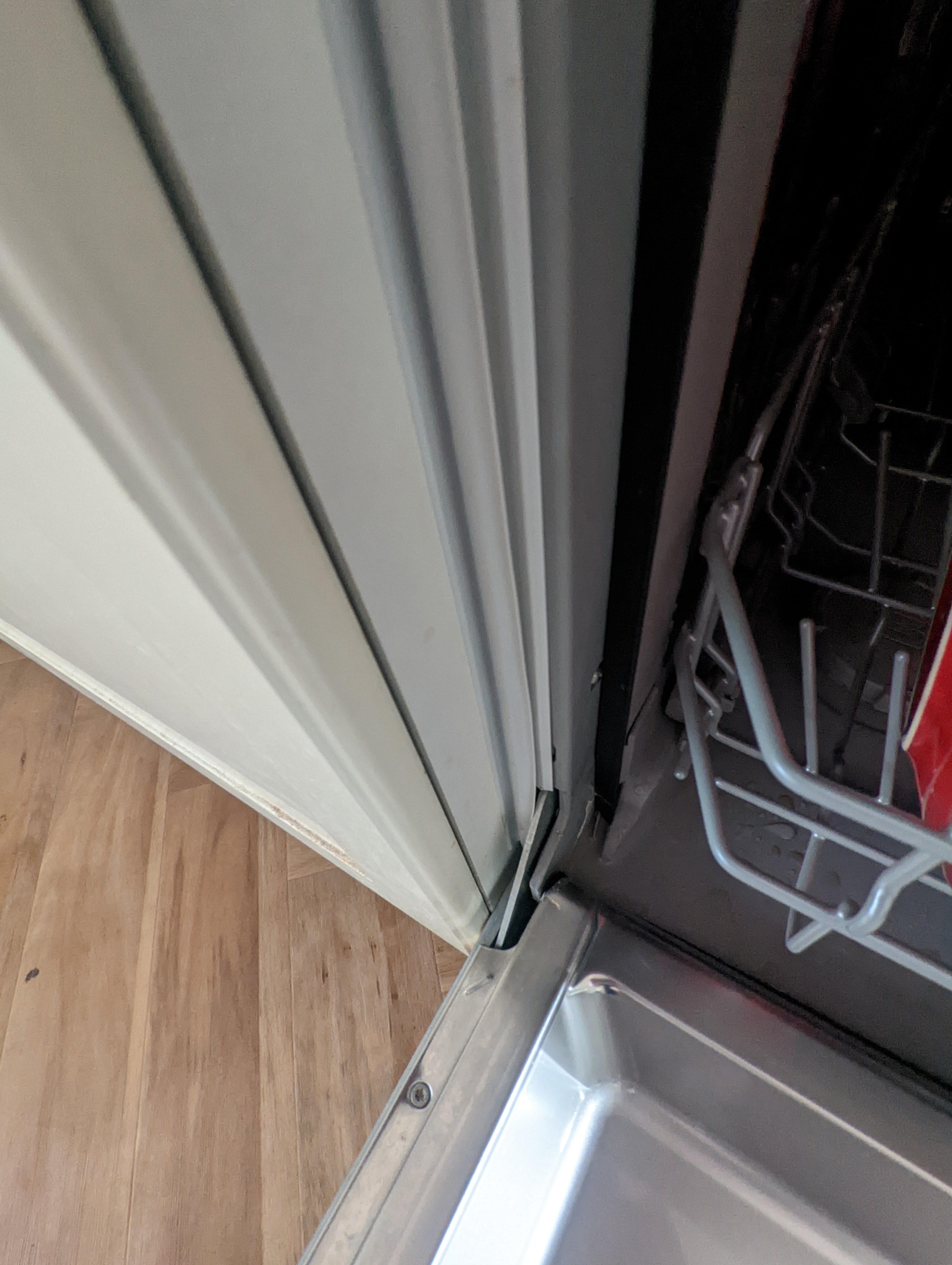

Hi all, I have a built in dishwasher which is catching in both sides (squeeking/friction in opening /closing)
Its not the adjacent doors unfortunately (as i can move them) it appears the opening is just too "tight". It's pretty much bang on 600 or just shy of.
Any ideas on how to fix this? Currently I've adjusted the adjacent doors to be tight to "guide" the dishwasher door but it's not the doors, it's the cabinets themselves
I was thinking of just multi tooling /reducing the thickness of the cupboards on the bottom section where its catching is that a massive bodge? I want to keep the kitchen as im currently painting the cabinets / going to change the worktop in future

The units are all tied together so don't think theres anywhere to go so to speak. See pic below. (dishwasher to left of sink)

Yep it looks like to be honest someone previously has already tried to chip it out thus you can see the grain of the carcass material adjacent (that or its worn away from friction)
I fixed it
Tried both the hammering either side trick (don't think it worked/did much but could be wrong!) )
Also shaved about 1mm off each side of the door (not noticeable as it's all been painted)
Works fine now!
