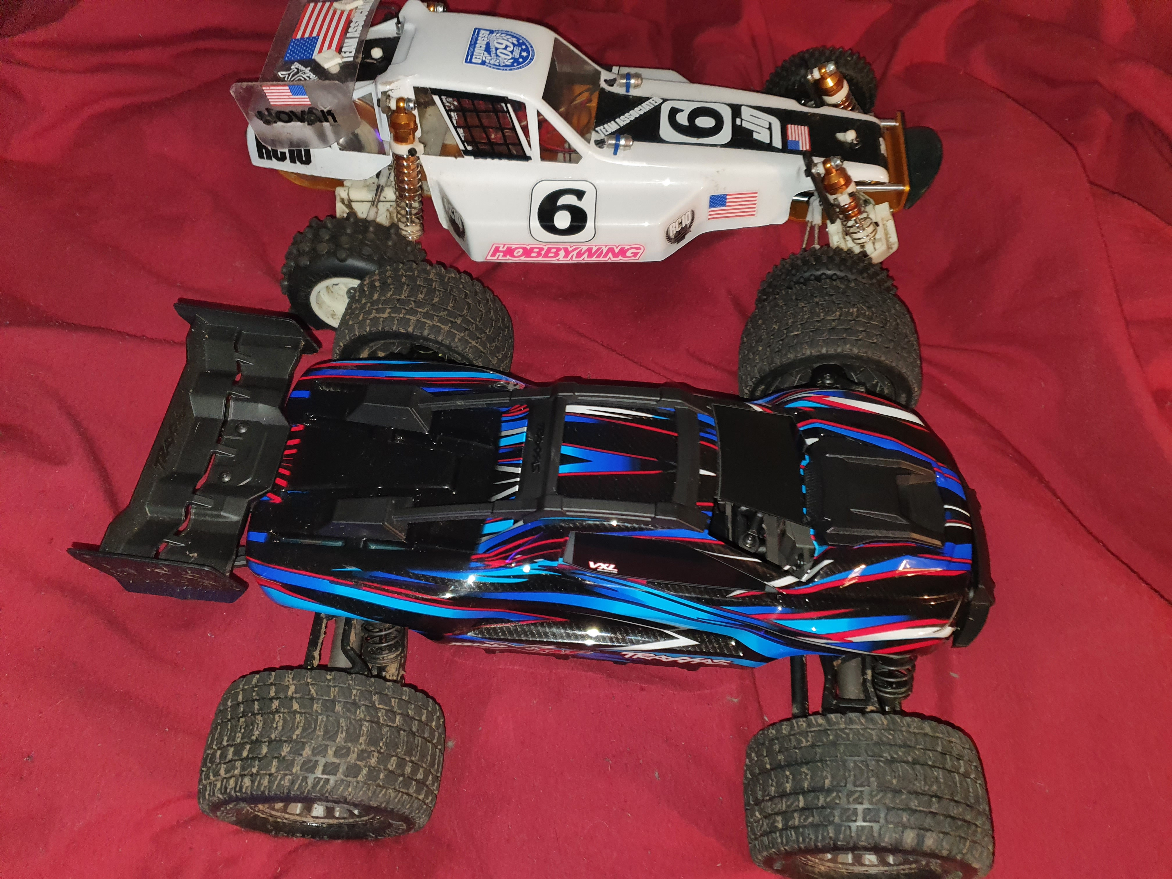

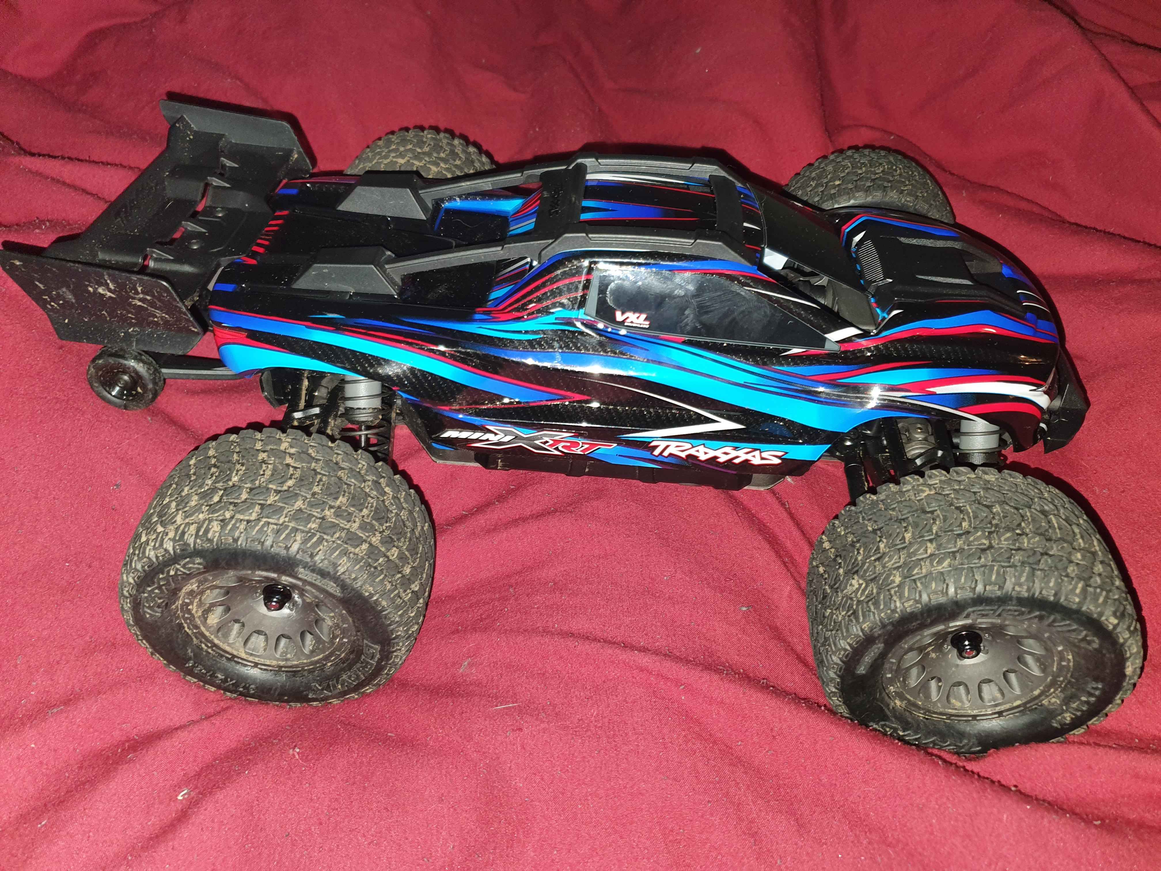

the traxxas mini srt came today and it is mental, weighs quite a bit, i was quite surprised at the weight for the size of it and then i took it out side for its test run and omg fast is a understatement and the handling was like a larger model, i am really impressed with it :)

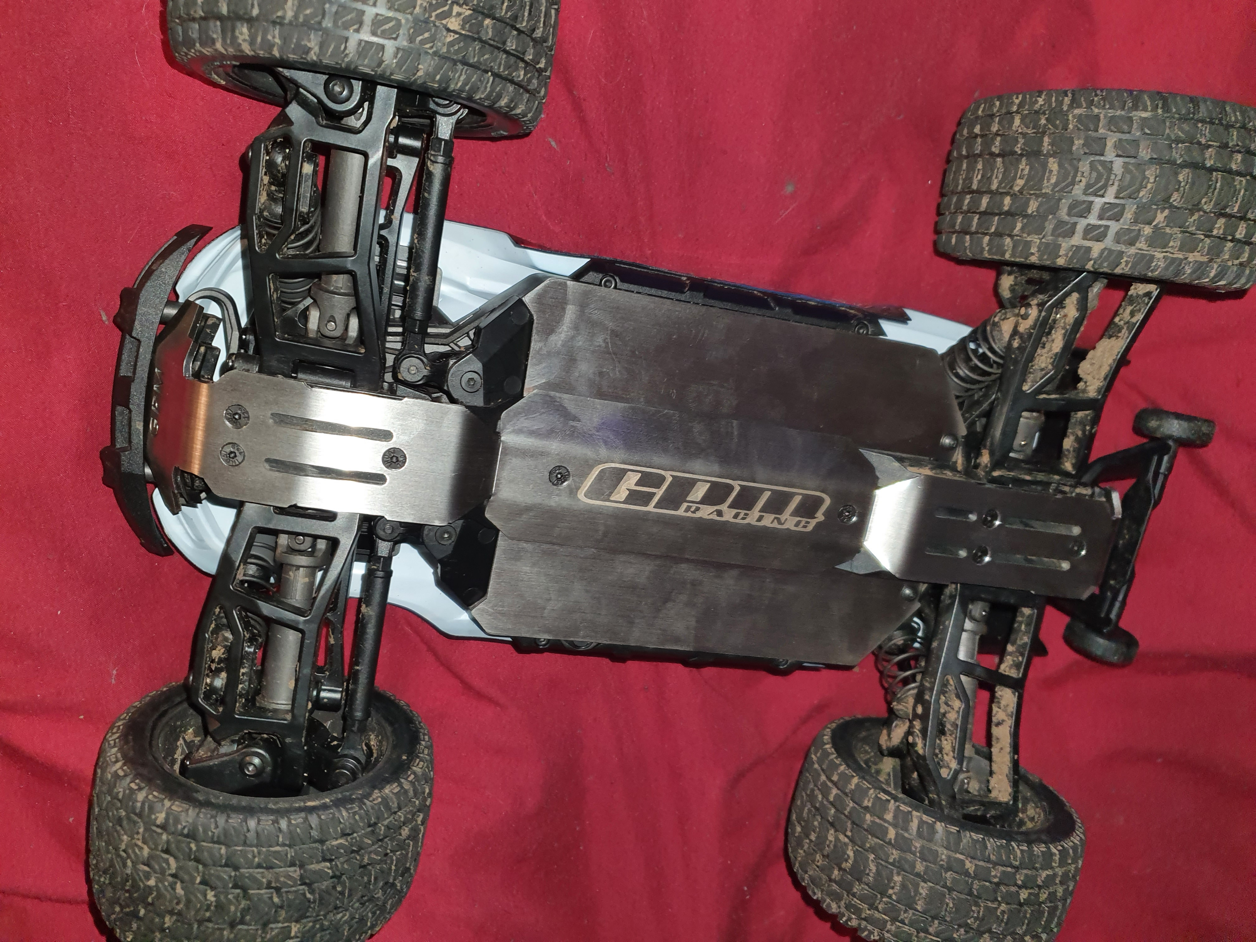

it did get pretty hot on 2s on the motor but i have a smaller pinion and fans for the motor and esc on the way which should help a lot and fitted a alloy skid plate to it.
edit: had a gap in my fleet after retiring my old thunder tiger xxt and xxb https://www.rcscrapyard.net/uk/thunder-tiger-sparrowhawk-xxt.htm the leccies from them live on in my konghead and bandit, but i was itching for a small fast stadium or monster truck to fill the gap, oh yeh im super happy with the mini xrt, incredible peice of kit, just needs tamed a wee bit to both reduce the speed and heat a little, the smaller pinion gear and fans should help :)

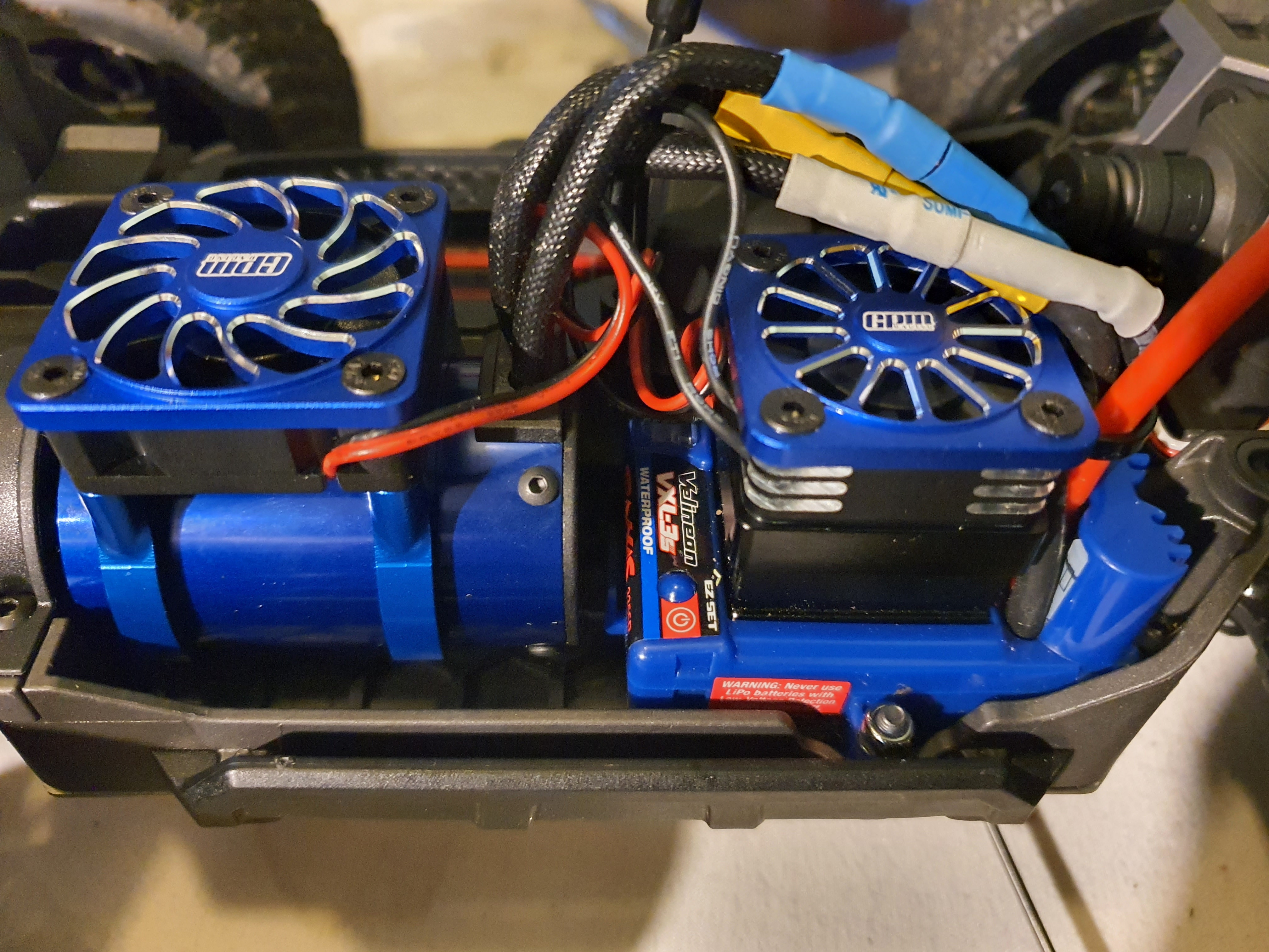

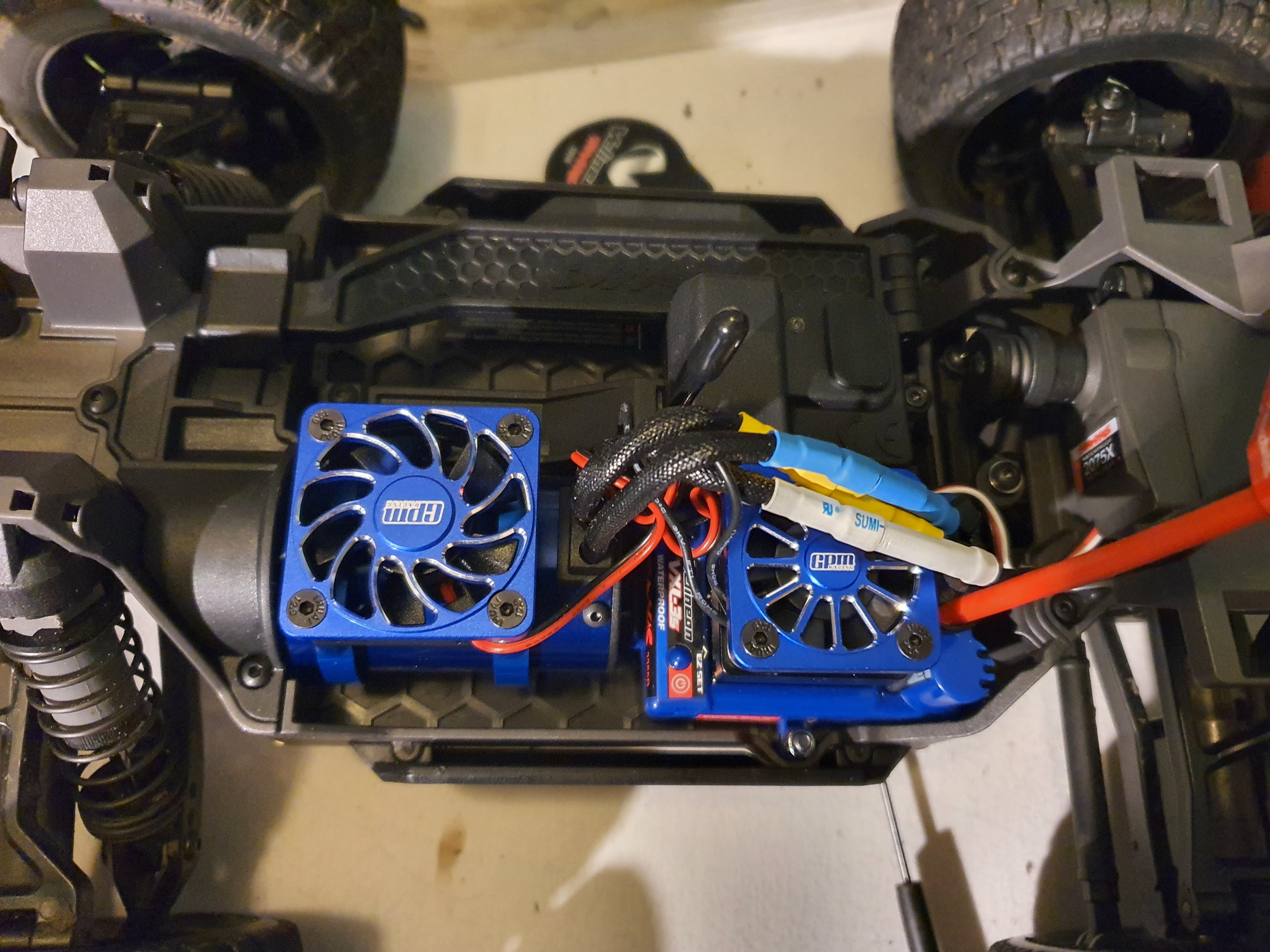

changed the pinion on the mini xrt to a smaller one and for some reason the mesh was really tight, it appears if you use say a 25 tooth one you have to put it in the motor mount for a 26 one or its really tight.
so should run a lot cooler now and fitted the fans to the motor and the esc, back ordered some adaptor leads so that i can charge the trx id batt with my normal chargers instead of the daft wee usb thingy that came with it, also got a metal spur on order incase i break the plastic one :)

gonna get a alloy center diff casing at some point, even on 21t pinion itwill still hit near 40 mph with 2s, removed the plastic cap from the end of the motor, it seemed to be clipped on tight and was impairing the air flow and the leads from the motor :)

woohoo tried the xrt with smaller pinion and slacker mesh and it ran a lot cooler, instead of been too hot to touch for more than a second it was only mildly warm when i brought it in the house, reckon i shall try some other pinions in the future and tweak it a bit maybe a 23 tooth :)
