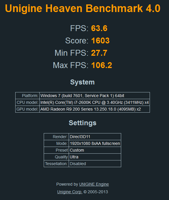

I am not sure that AMD cards are as bad at Tessellation as some people say, I find my 290Xs seem to do quite well with Tessellation from the limited amount i have seen. This is the reason for doing the above exercise to see if it is the Tessellation in Heaven holding the cards back or it is something else.
13.11 sig rig all stock, xfire disabled, settings as advised

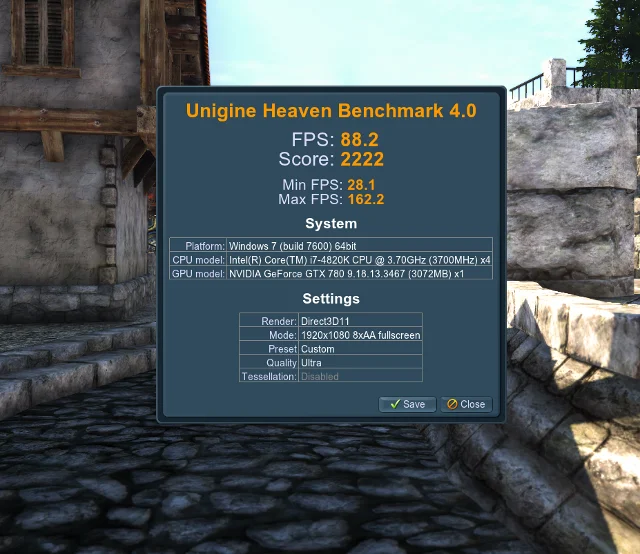

GTX780 (not at stock). Pretty sure I can get that upto atleast 90 as I wasn't quite at max clocks - 1250ish on the core.

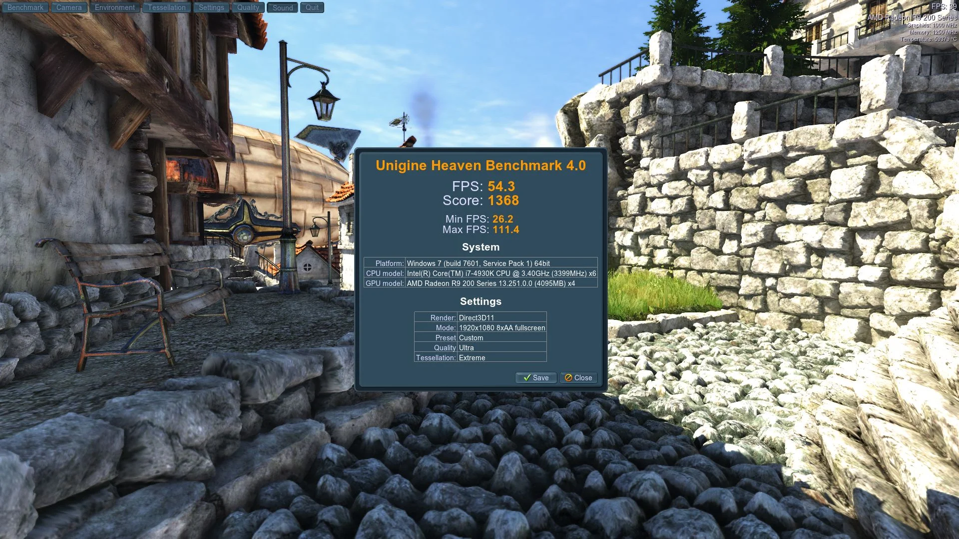

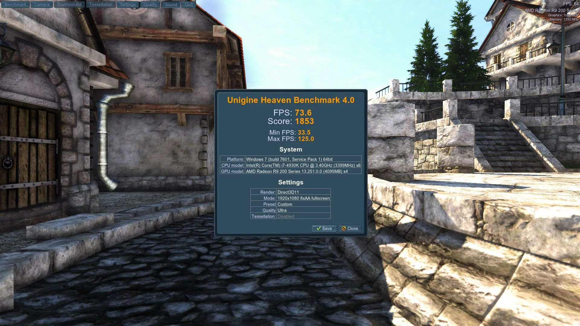

Stock 290X @1000/1250
4930k @4.7
With extreme tessellation
With tessellation disabled
Increase in FPS 35.45%
