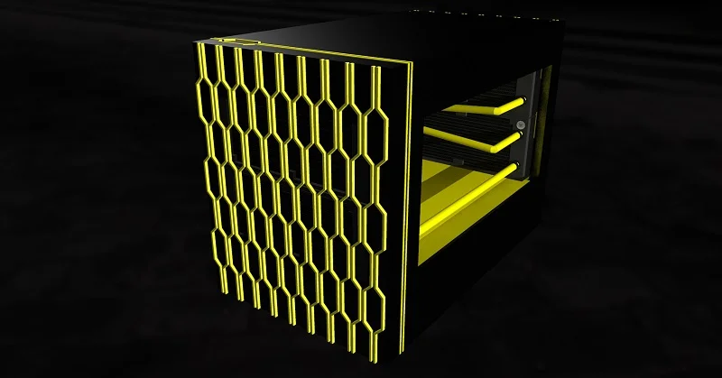

The Case:

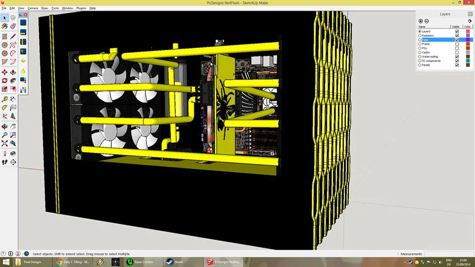

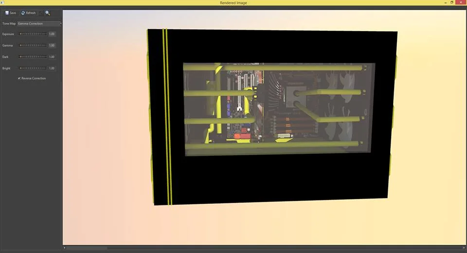

Here are a few renders of the case, I'm really not an artist so the settings are all fairly default :(
The case is an aluminium frame which holds the components and an acrylic shell that keeps it all looking pretty :)

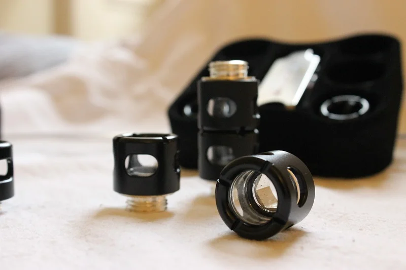

The watercooling I will be putting into this build is:

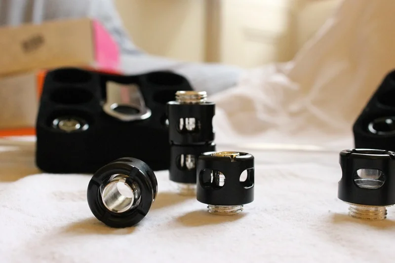

Fittings: Monsoon hardline and soft tubing (spattering of other fittings for drain port etc)
Pump: EK PWM D5, With EK top.

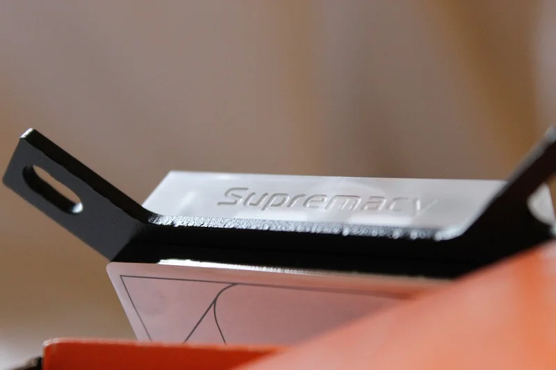

CPU: EK Supremacy Clear
GPU: EK original CQC 290x block (Which I will polish clear)
Rads: EK 240 PE

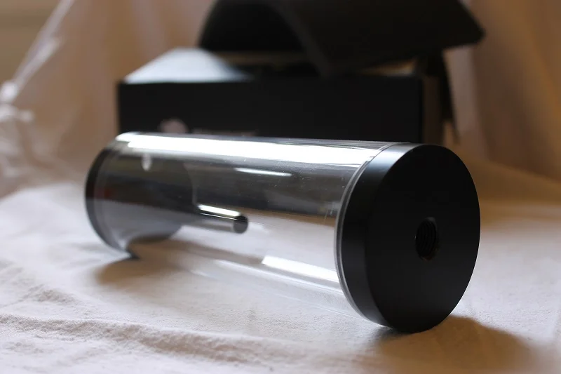

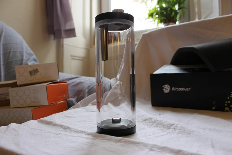

Res: Bitspower 170mm tube
Controller: Was going to be an EK Acendancy but email from EK today says it's shelved so Aquacomputer aquearo

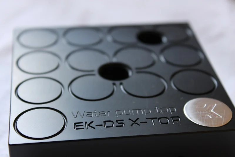

Temp sensor: XSPC G1/4" Plug
Fans: currently have 4 Piranha's in their boxes. But I've bought EK Vardars instead

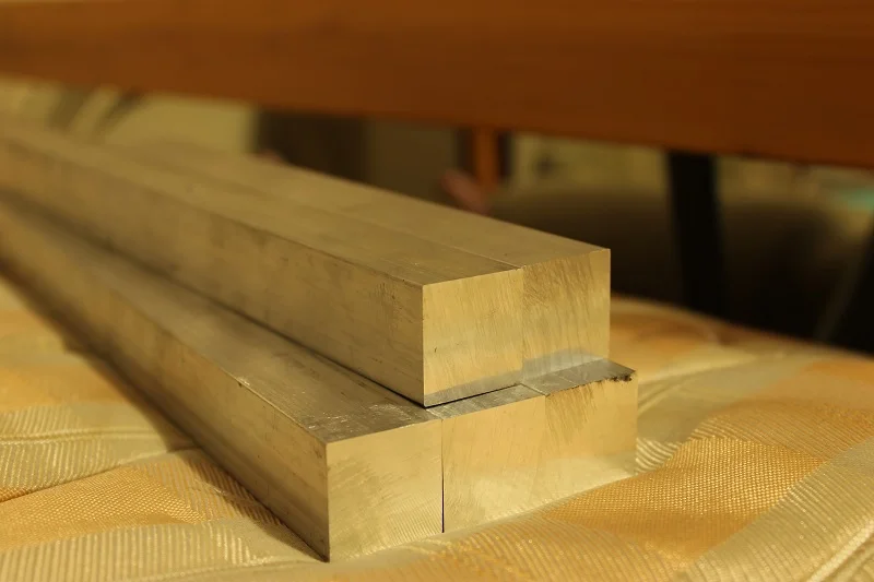

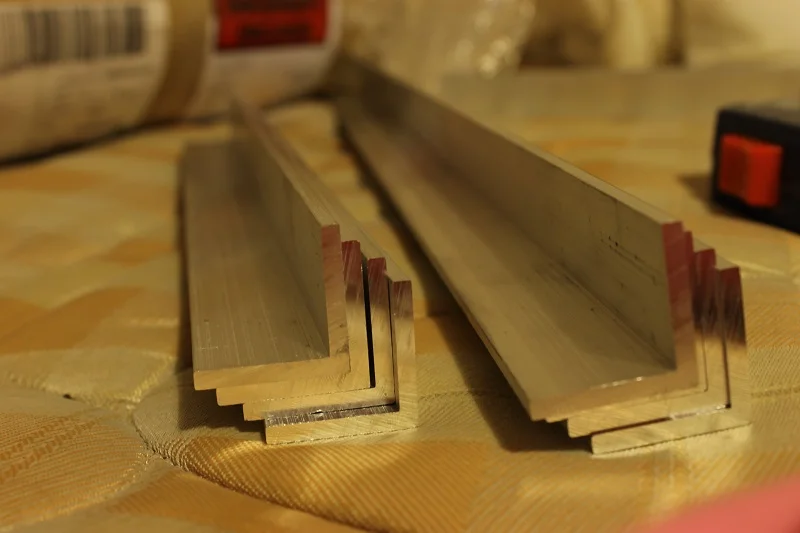

Metal arrived:

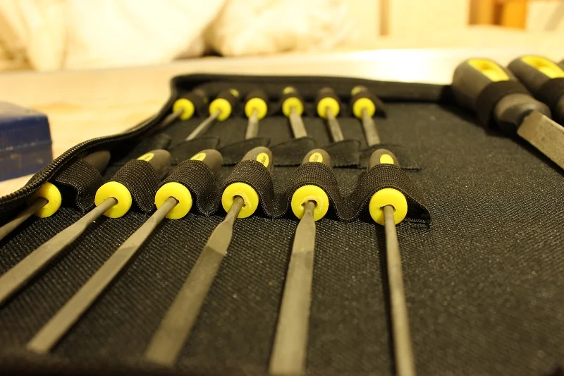

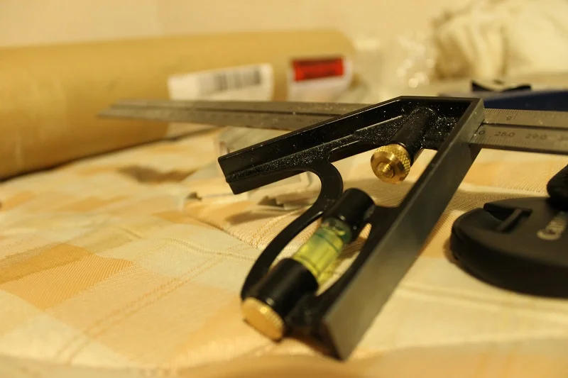

Tools too:

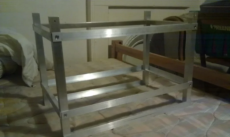

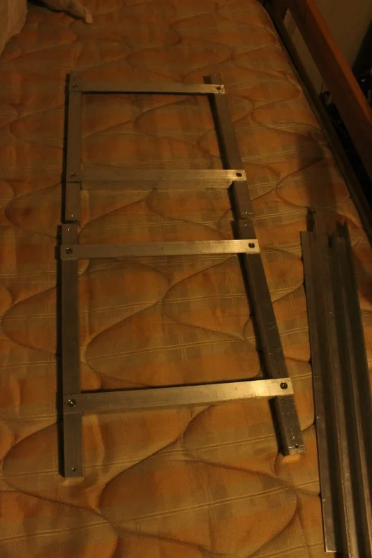

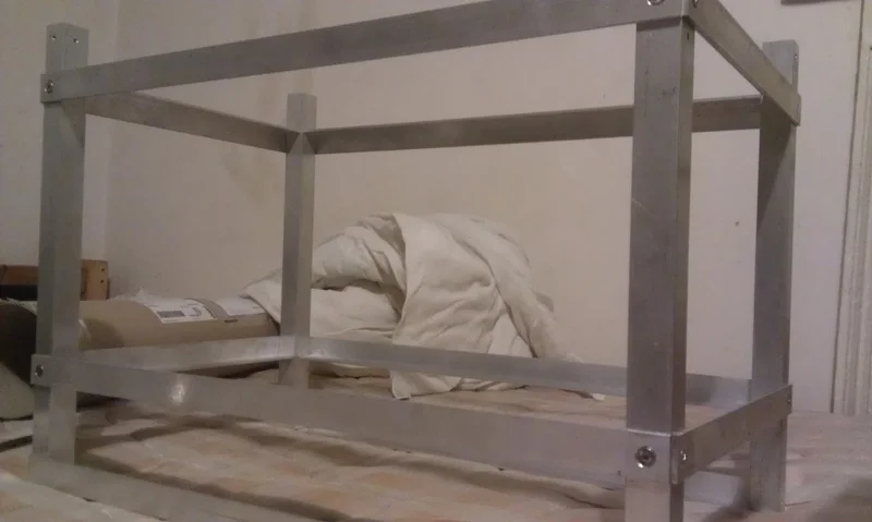

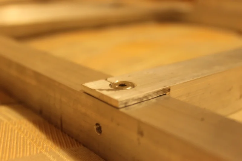

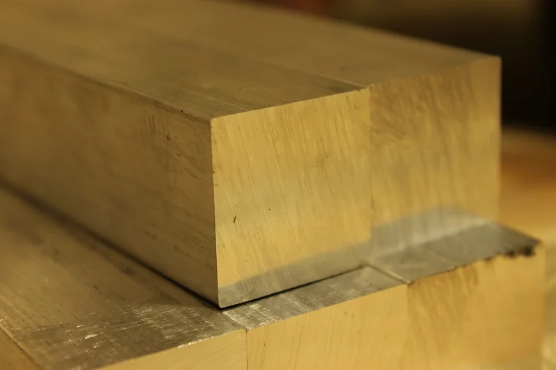

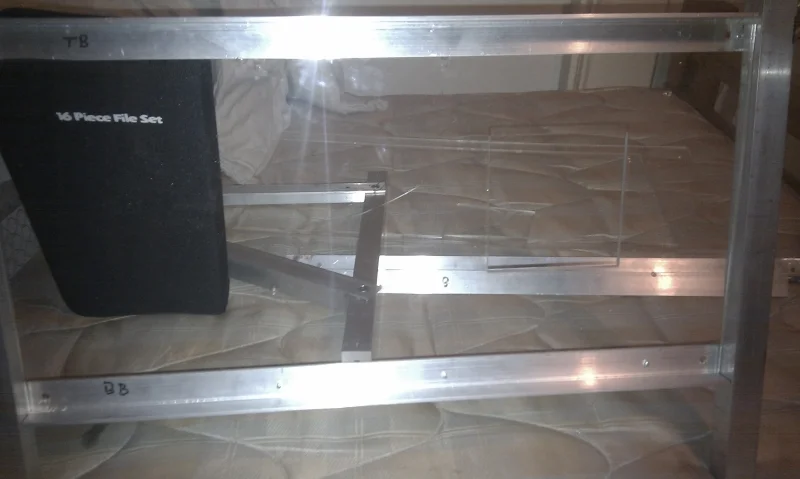

Case will be constructed of Aluminium angle screwed into 25mm square bar.
Cut all the angle down to size(Thanks Dremel):

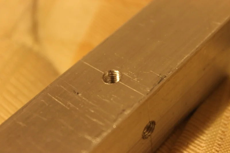

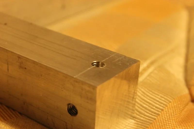

Drill and Tap all the Square Bar:
DISASTER!!!

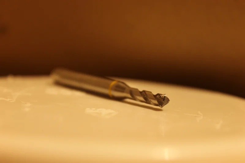

3 holes to go and I get a little too excited and:
Snap my tap......
So annoying, that tap end is in there tight, nothing I can do is getting that out with the tools I have. It gouged a chunk out of my pliers :o
Lucky the bar could be turned around and I drilled the other side and it went together fine. A bit of filing flattened out the tap bit.

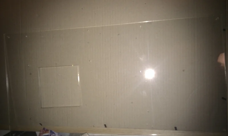

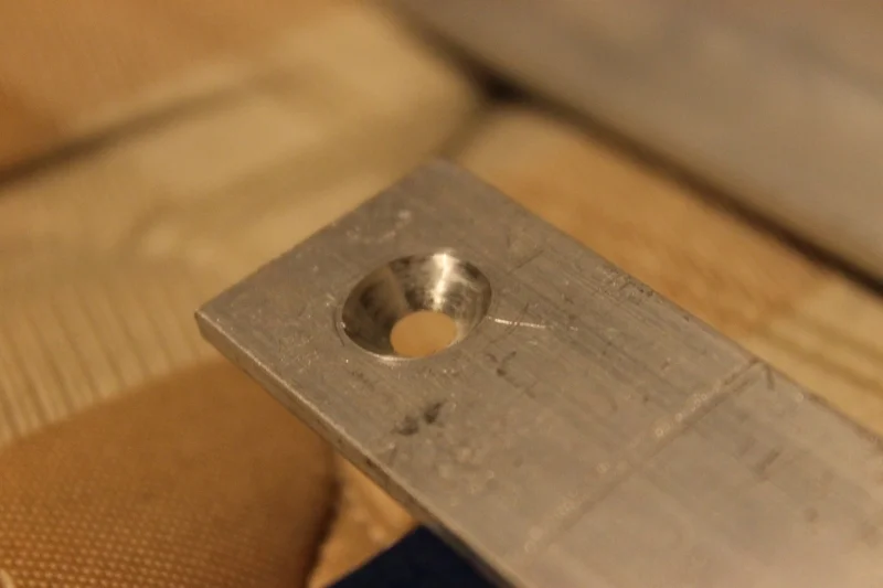

Countersink the Angle so the acrylic can sit flush on top of it, I didn't have a drill slow enough, so I had to do these by hand turning the chuck :(
It FITS!!
Sides together:
Finish the rest up:
Work going well :D

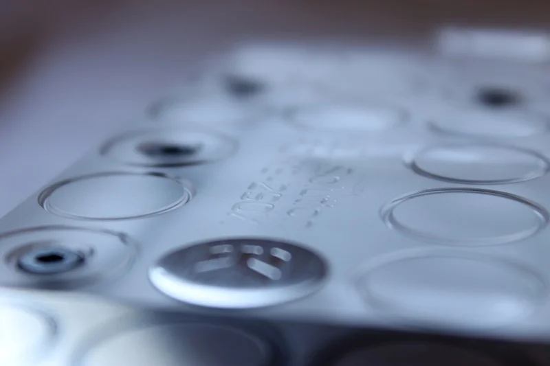

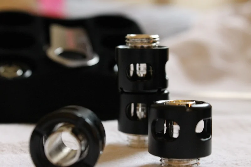

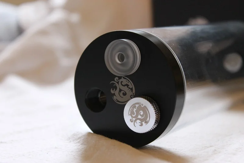

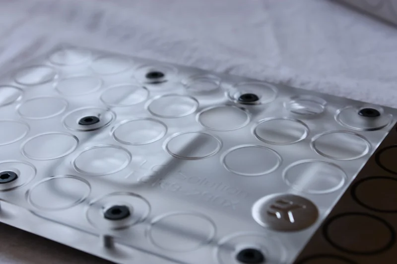

To Tide everyone over I will finish with my first attempt at taking component pictures (photographers should look away now! )

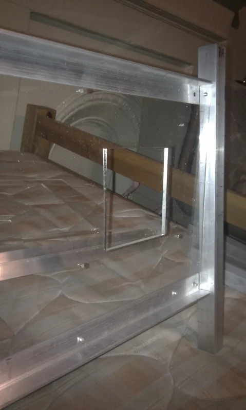

Mini update from last Night:
I went to get my prototype MoBo Tray cut and my file was not right :(
Some problem with the .dxf export.....I Dunno but a bit disappointing.
To console myself I finished off drilling and tapping the last mounting holes for the panels and countersunk the mounts for the Mobo tray and window.
Getting there :p

@petey well I could let you know now, I kinda regret the Square bar.
Box section could have done fine and saved a lot of weight. either tapping the box or rivnut it.
But I have the metal now, who cares if the case weighs a ton :p

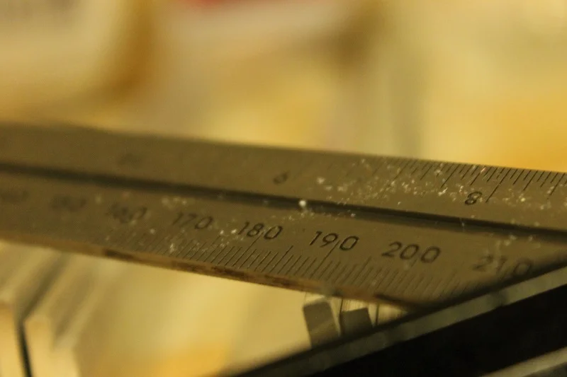

At the weekend I wore out my last cutting disk for the dremel :(
I have other not Ideal ones, but they're slow going :(

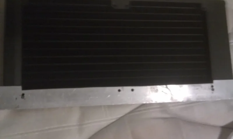

I was trimming the metal that holds the Rads in place, allowing more airflow. I was also measuring up the holes to mount the Rads.

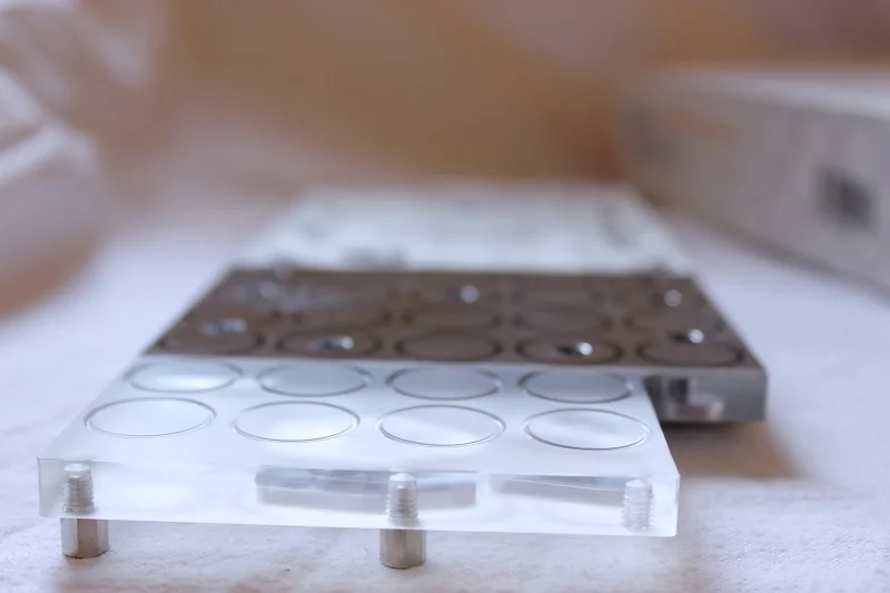

so now I have my first pass mobo tray:
It fits in:
I also drilled my rad mounting holes:
Now it's hard to see there, but I'm well happy with those holes, they line up freaking perfect :D

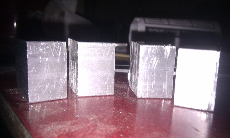

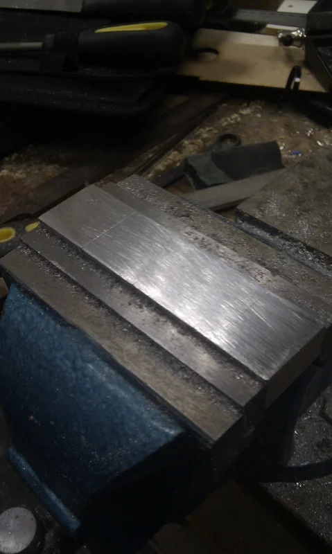

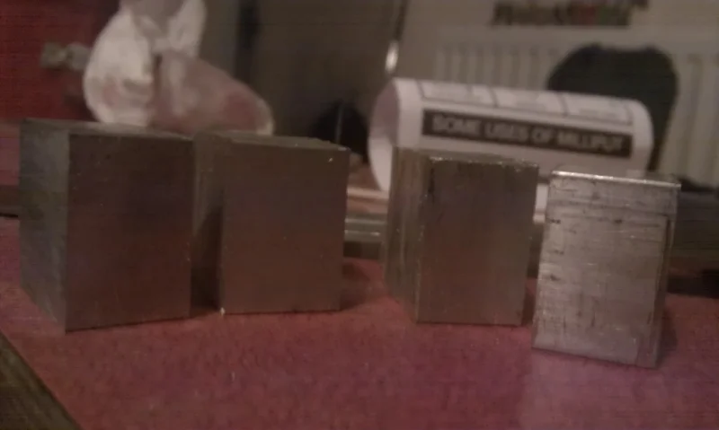

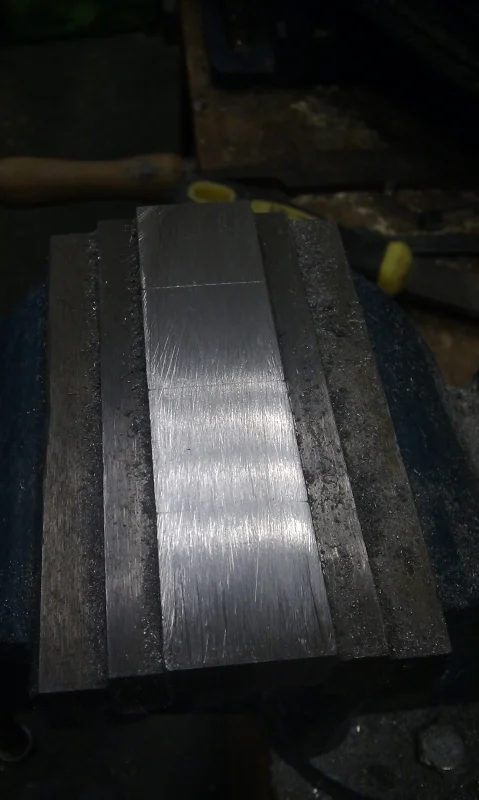

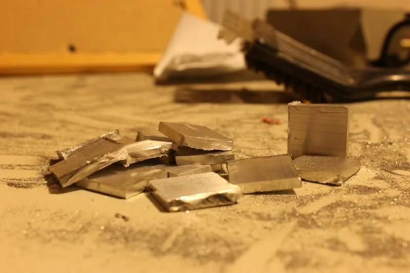

Last but not least I cut up some bar that will be filed down to make feet:
I will file these into hexagons to follow the 'bee' theme and either polish them up or paint them :)

I drilled the rest of my Rad brackets, still need trimmed for increased airflow.
Need to file some bits down for neatness and evenness.
Speaking of filing:
FEET!!
3 hours of filing and they are all the same size and flat.
Need to get the corner's off, drill and polish and they'll be done :D
