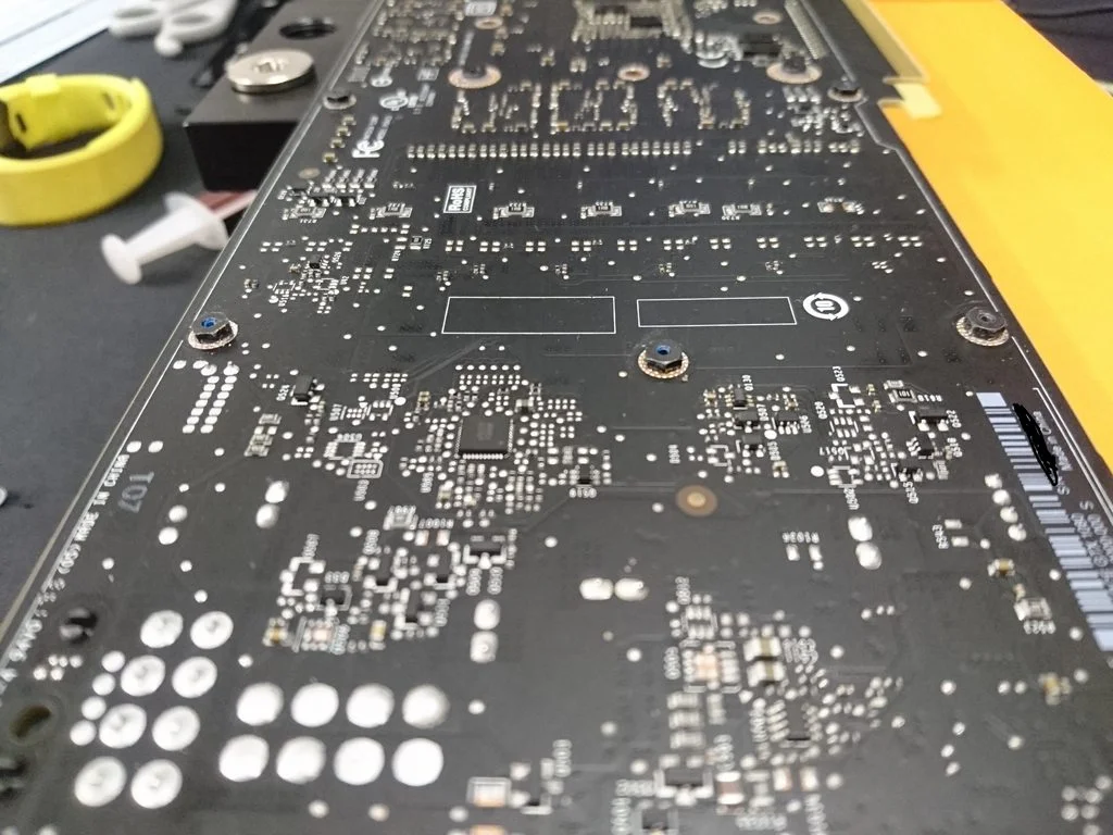

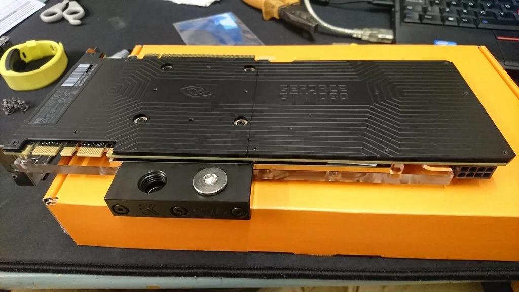

EK 1080 Waterblock + Founder's Backplate
30 Dec 2013
6,611
GPS signal not found. (11)
EK's website explicitly states that these are not compatible together.
However the hex screws that hold the founders cooler to the card and subsequently the backplate too are a perfect fit on the EK block.
And therefore you can install the founder's backplate onto the EK block.
The only difference is that there are a couple of screws missing.
Which makes me wonder why EK state they are not compatible?
To give EK the benefit of the doubt they may not have known that the backplate would be compatible as I know they struggled to get a physical card to design their blocks around.
However the tinfoil hat wearer might think that if they admitted that they were compatible, then that would destroy sales of their own backplates.
Hopefully this will save someone a few quid in the future or just provide some general info.
Yeah same with other previous cards, EK say not comptabile but if your use the Nvidia screws then the original plate fits.
No idea why EK keep saying this, I can only presume its to increase their sales of back plates.
Although their backplates are aluminum and come with pads to dissipate the heat away from the back of the cards.
Thanks for this. The original backplate looks better than the EK one in my opinion. Just wish I hadn't spent the extra money on the EK backplate...
