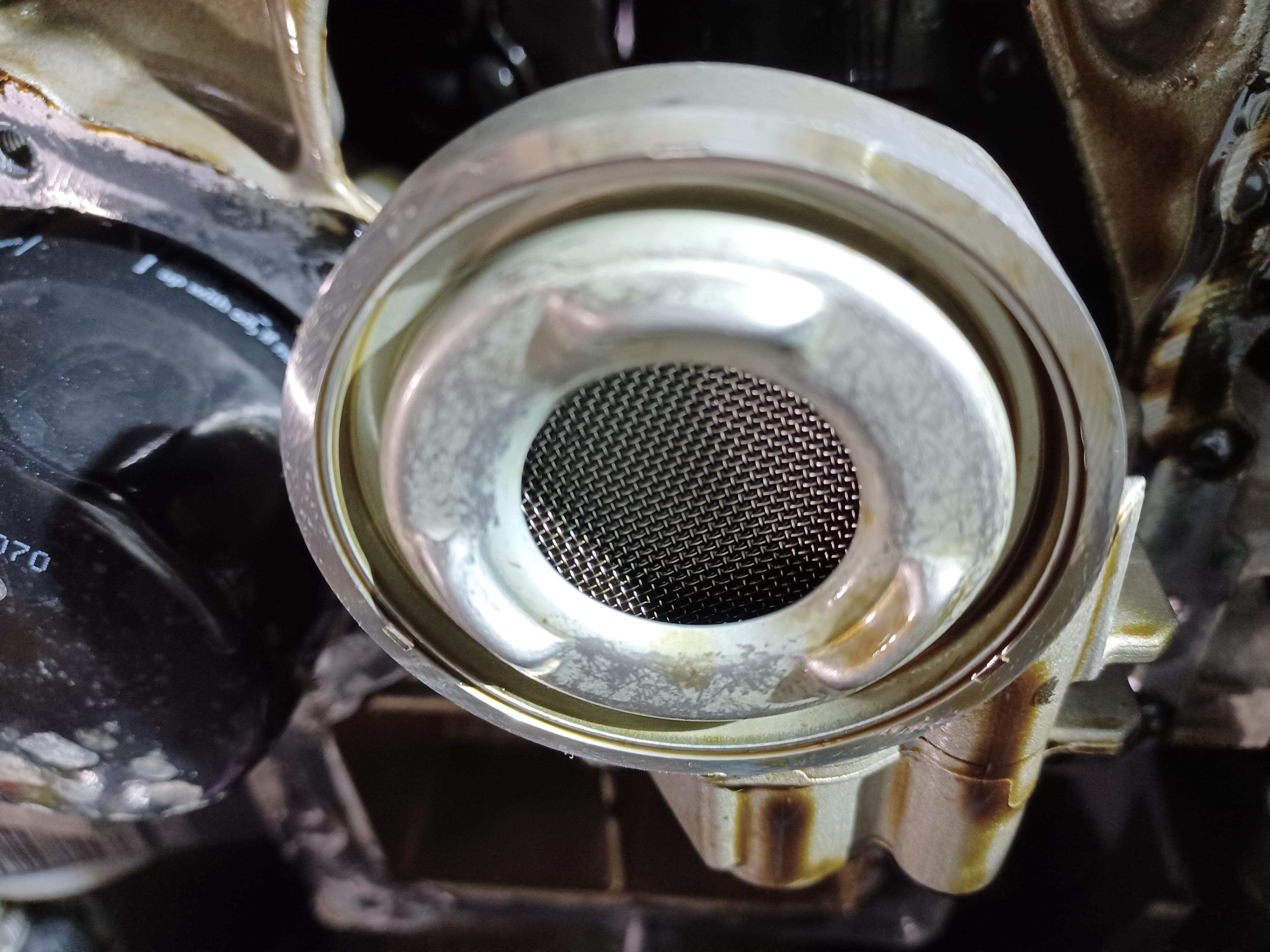

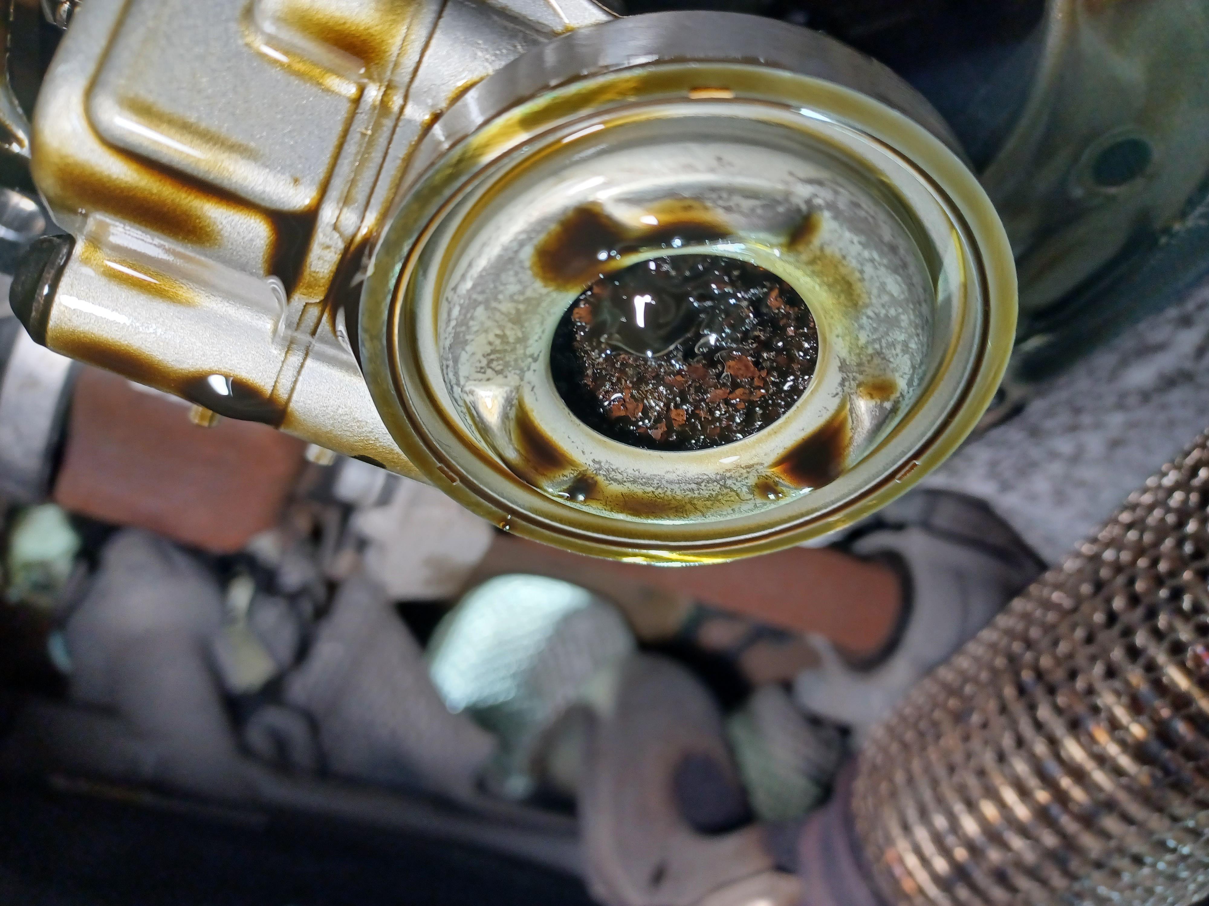

TLDR: Have an oil pressue issue, think its the wetbelt. No time to wait for dealer or garage so confirmed pickup tube is blocked with belt, replaced belt myself here

You are right it is most likely the belt breaking up and clogging the oil pickup.
This is all doom and gloom, but really needs a proper look at, and only real way to do that is removing the sump.

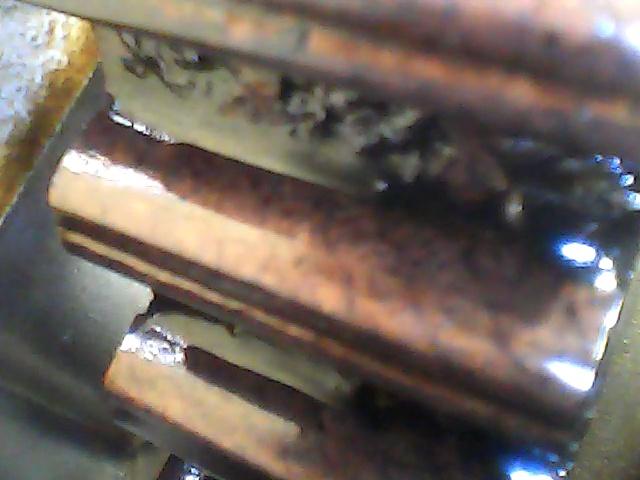

Had a look with my endoscope and the belt itself isn't missing teeth as far as i can see but it sure does look to me like its been shedding stuff due to the uneven surface above the teeth
The engine isn't trashed so it's obviously not lost teeth, but just because your engine is not seized does not mean the belt has not broken down.
your symptoms suggest the oil pickup pipe may be blocked, and is getting insufficient oil as the engine speed increases.

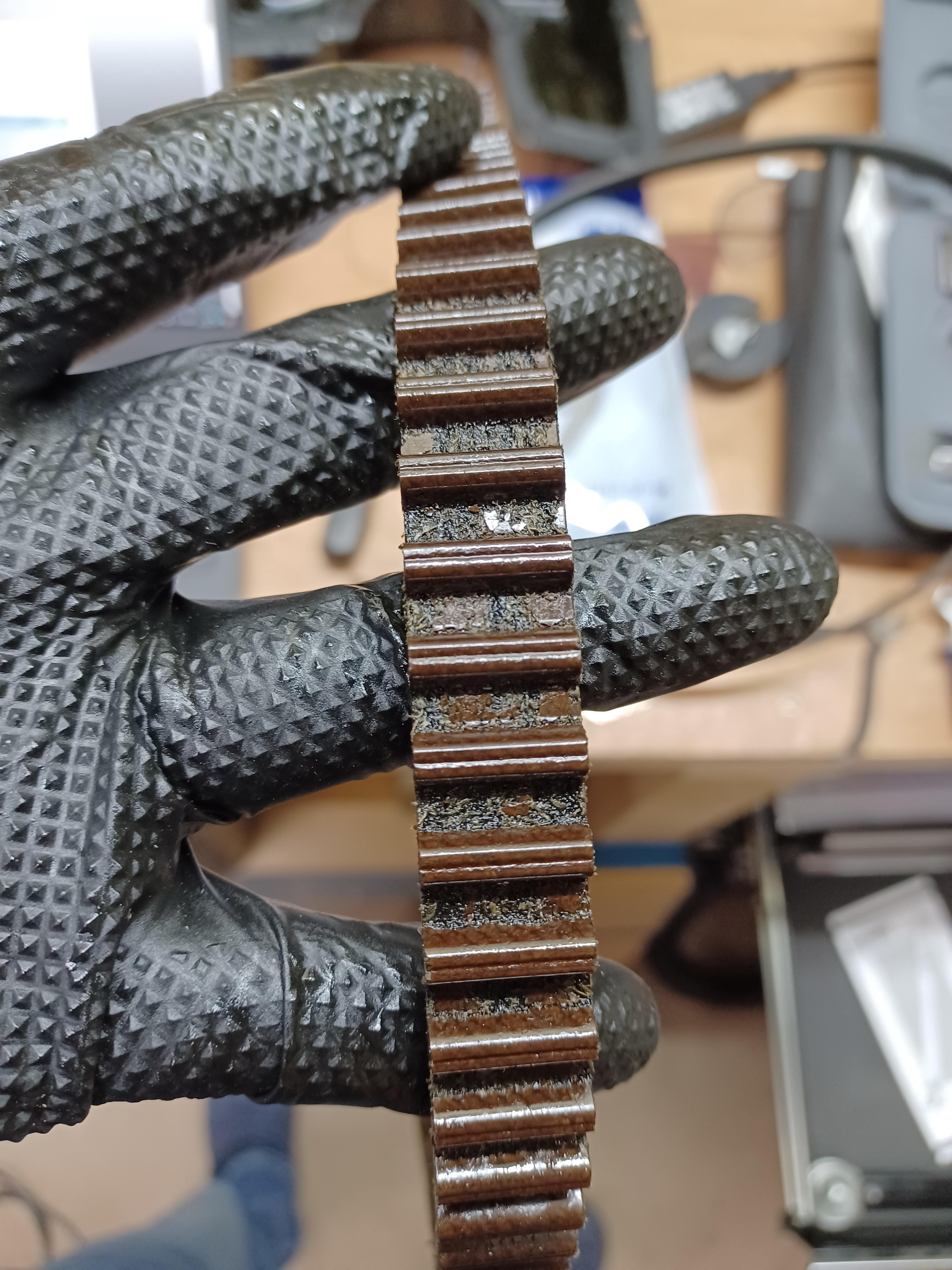

I've rebuilt one of these engines, though my brother's was rebuilt for excessive oil consumption and he had the turbo version, his fault was the oil control rings, they have a design flaw where the drillings are very fine and clog up with carbon, I modified the pistons by drilling 4 of the holes larger in the piston skirt and told him to half the oil change intervals to prevent it happening again (I digress)
His cambelt was only a year old at this point and the correct oil used (supposedly), when I removed it, it was all cracked between the teeth and on the back of the belt.

You will need to do the following or pay someone to do the following
Remove gearbox
Remove sump
Remove cambelt
Remove oil pump
Clean oil strainer (might have to replace oil pump to be sure it's clean as the gauze has multi layers)
Rebuild in reverse with all new components. The cambelt I recommend is dayco as they are factory fit if you don't want to pay Peugeot prices. I'd also advise looking at the clutch as it's off and inspecting the dual mass flywheel for any play. LUK are factory fit for the clutch and flywheel (surprisingly not valeo).
In theory the oil filter should have collected any particles that made it past the oil pump and strainer, so you will need to replace the filter also (purflux are factory fit on oil filters for these)
New high quality engine oil (total quartz ineo first 0w30 I highly recommend and is factory fill) of the correct specification

On this engine i'd class it as advanced DIY - as always access is the main killer! If i had a pit or lift life would be bliss. You don't need the full head cover off that would exposes the cams (unless you want to inspect them). Theres a partial plastic cover that comes off with a few pipes to remove and the spark coils. I didn't buy the newest locking kit so had to take off the vaccum pump to lock that cam.

Just an update, got back from Italy this morning with the inlaws after driving it to Manchester and back (5 adults, 2 kids with 3 checked in luggage’s on a roof rack! Sufficed to say that 1.2L was doing work shifting that over the Pennines). This was the main reason I was in a rush to get it into a better state as I didn’t really have any alternatives for airport transport or anyone else fixing it with a few days’ notice. I can't feel it functioning any diffrent besides no more loss of oil pressure at high RPM but going to be doing more checks/replacing just to be sure when i have the luxury of more time/planning. Keeping an eye on oil consumption as well as it was using a fair bit before (but within PSAs stated tolerances). The engine is notorious for using oil though so i don't know if it'll actually improve or not.
Not sure if related to the belt wear but the belt tensioner on the factory fit was over tensioned, by about 30 degrees past the mark.

Thats about right for time I spent on it - correct with garage and car being on ramps, also I have all hand tools. Now that I know what I'm doing I could probably get that down to nearly half that on a reattempt and a few hours if you had garage level lifts/access/tools. Its much easier if you can take off the front wheel for access to the side through the arch, but thats a bit hard when you're using ramps :D. The scariest part for me was doing the crankshaft gear bolt. That one wants 50NM and then 180 degrees..
