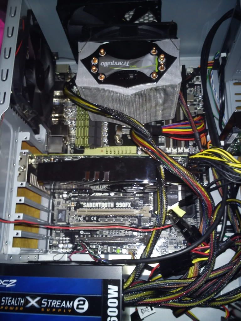

Here is my cable nightmare - the PSU fan and mains only just reach
http://i448.photobucket.com/albums/qq204/jenno_d/IMG_20111103_184357.jpg

Cheers Gashman - I'll probably order some extensions at some point if I can be bothered.
Luckily my case doesn't have a window so I can just close the lid and forget about it :)
