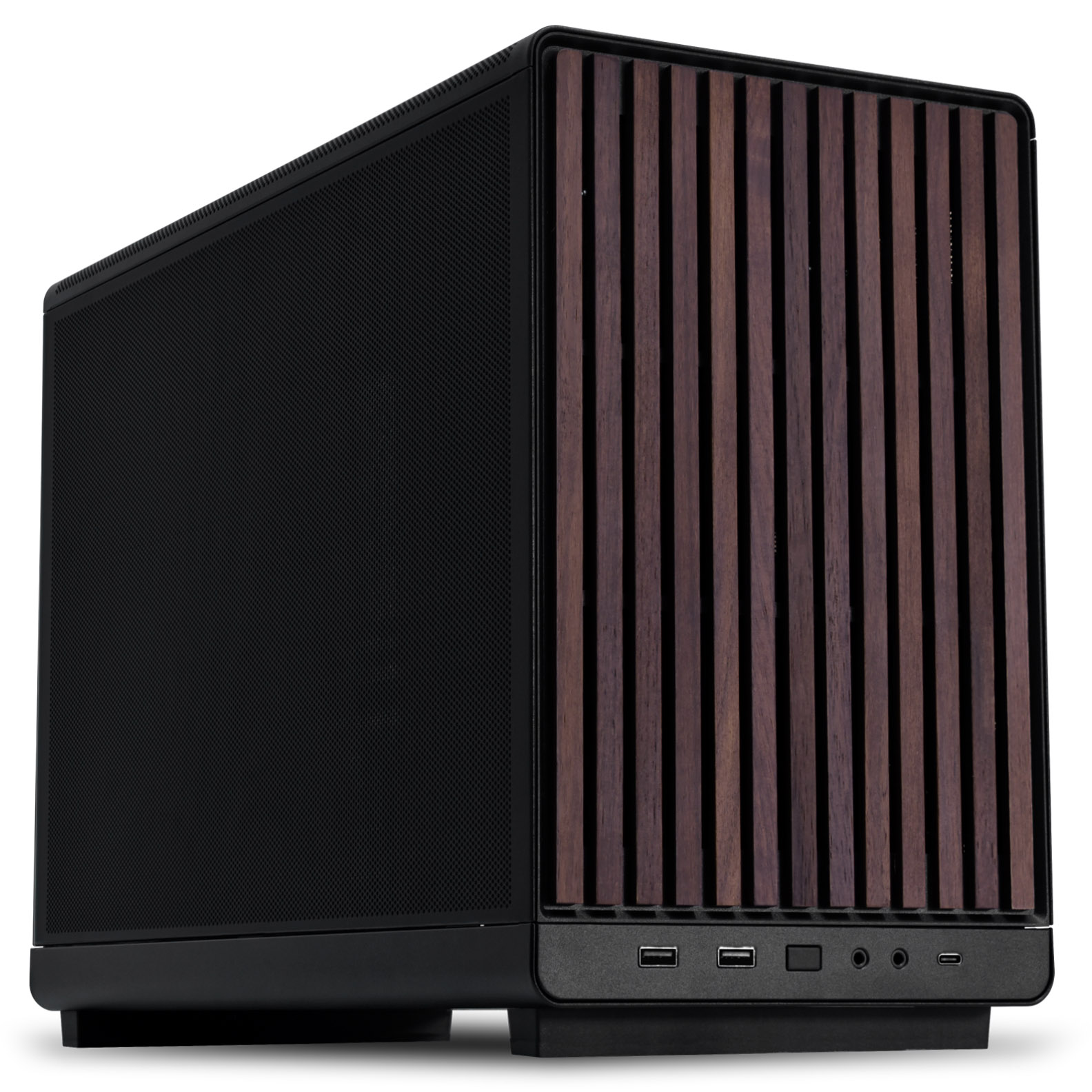

Picking a case without RGB or glass panels is tricky. I don't know how good the observatory is, so you might want to shop around. There's a b-grade Phanteks P200 which was tempting for this build, but would have needed an ITX motherboard.

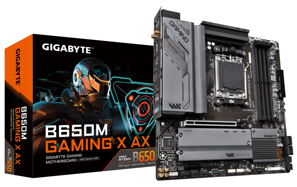

am5 build, leaving upgrade options down the line. Not putting a screen on as ideally i would want one with 144hz or higher, unless you plug it into an oled tv where the 120hz countered by instant pixel response
if you can stretch to a 2tb ssd, even better as games are getting large...seeing as for your daughter gone for some rgb...white might be nicer also, but there's a white tax to contend with...shop around..seen the cpu cheaper or 7600x similar price with free delivery

My basket at OcUK:
Total: £1,535.89 (includes delivery: £0.00)​

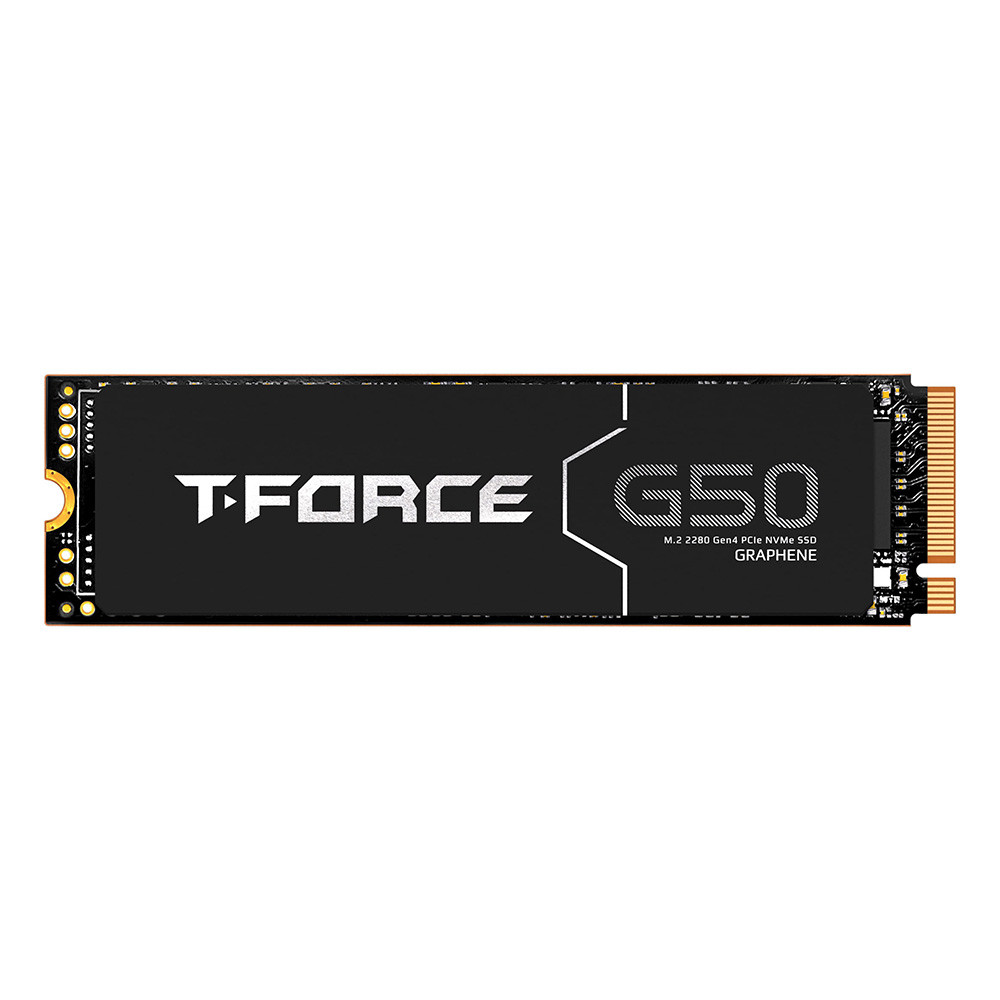

That NVME drive is Gen5, but the motherboard takes Gen4. (pci-e 5 is for GPU only)
Swap for either of these 1TB or 2TB drives. (or both ;))
My basket at OcUK:
Total: £162.94 (includes delivery: £3.99)​

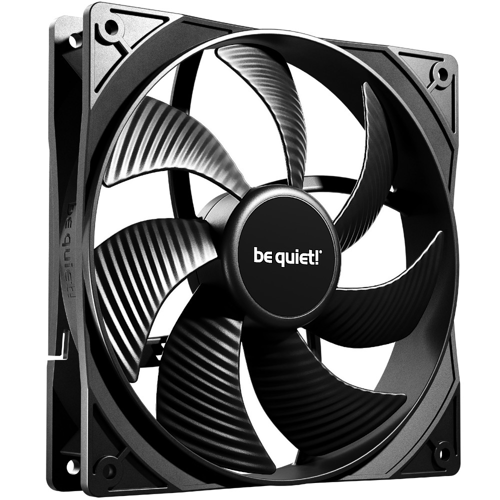

Do you need the extra fans? Case comes with 3 x 140mm fans included and should be sufficient.
I was thinking of adding the three fans up top, thinking more fans would run slower = quieter?
Cheers for the PCI info, I indeed thought it was for m2 support.
Possibly with the fans, but it might disrupt the airflow and make it less efficent.
I would try with only the supplied fans (2 in the front and 1 in the back) and use the blanking plate on the roof of the case.
If it does not cool enough, swap to the vented roof plate. If still not good enough, then think about adding fans.
