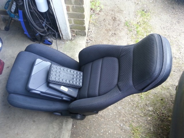

So I looked at all the options I had to sort the seats. You can spend a lot of money on leather covers, new foams, and new rails/frames/etc, but i decided to see what else could be done. It seems that MX5 seats are touted as a good sized replacement, but would need custom mounts.
So, i bought these seats on ebay for £60:

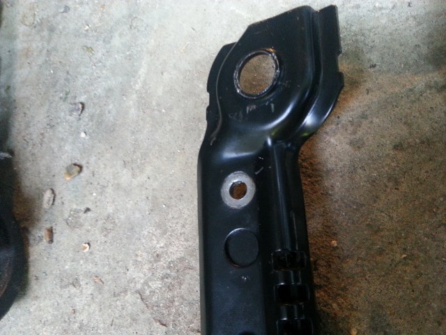

So, the first thing to do was bend the end pieces flat, using my vice, this was nice and simple, and the MX5 rails were now correct for a flat floor.
Then I needed to deal with these locating lugs, as I really don't want to drill holes in my nice floor!
Bit of time with an HSS drill bit, and I had this:
A bit of precision bashing with a hammer, and I had this thing falling out:
Which left me with this:
Repeat 3 more times, and no more annoying locating lugs!
Funnily enough, once these were removed the new hole was the perfect length to install the rails into the old holes. Problem is, they are not wide enough! So some extra fab work is needed.

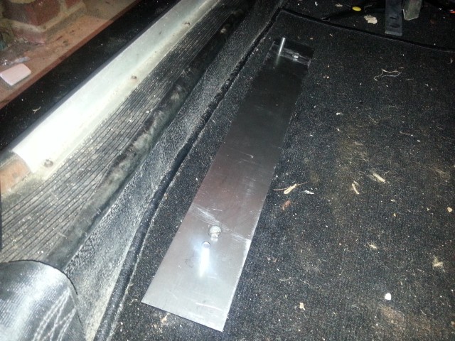

I got on to a local steel firm, and had them make up four 500mm x 70mm plates, and I planned to team these up with some nuts and bolts I had lying around:
So, first things first. Screw the original bolts into the floor, and leave the heads raised. Cut some cardboard to shape, and push it into place, push the bolts heads through (or cut them if your neat!) and this gives you some idea of where the original heads are.
Now, the clever bit, slide the new sea on its rails onto the template, which is quite tricky in a small garage, so I went in the back door (ooo-err), like so.
Then poke through the mounting holes on the new seats, so you mark the cardboard.
Once you have done this, you can remove the seat. Then you should be able to fit the template, like so, onto the removed seat:
Ok, so now the hard work is done! Drill the holes to the correct size for the bolts you are using into the steel blanks, tap a thread into the holes for the new seat mounts (makes it much easier to fit and re-fit the seats later, and you have this:
Repeat with the other side, and you have this:
You can test fit at this stage. Once you know the fit is correct, remove the bolts from the steel and give it a quick coat with whatever paint you have lying around.
Now move the steels under the carpet, make the correct holes:
Install the new seat, do it up tightly, and use washers :)
