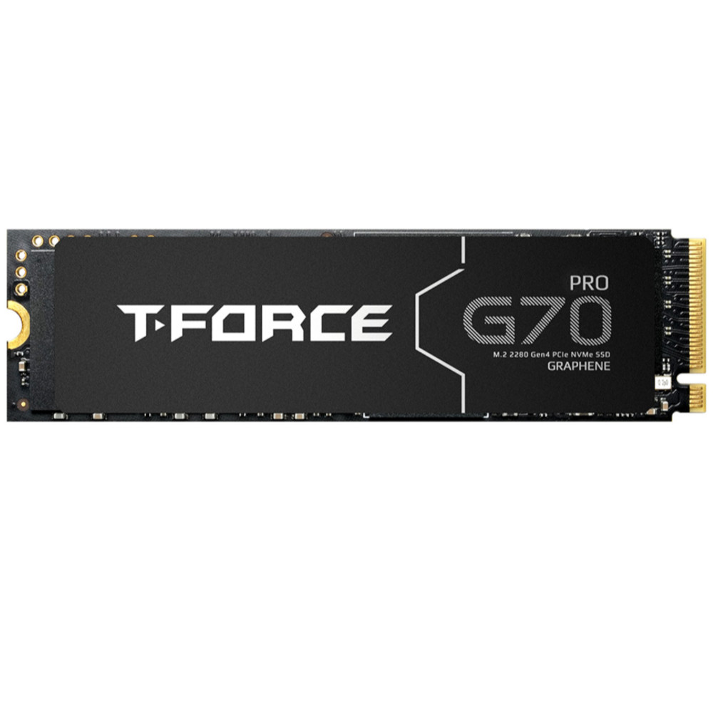

I recently bought one of these and would recommend it purely for the extra longevity (2000TBW), although it also represents good value.
As for RAM I'd also echo 32GB of 6000MHz CL30 if within budget, for a good balance of price/performance.
thanks, Kingston fury it is. We’ll get that through the website as it’s the best deal we’ve seen.
