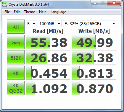

from a previous thread of mine i found this is what i get on my raid0 and standard 3.5" drive :

and this is what my 2.5" drive got :
so there will be quite a speed decrease :(
but how about in raid? or will the fact they are slower drives just not make it worth the effort?
I would have thought the fact they are 5400RPM drives would mean putting them in RAID would provide very limited benefit.

right, now after reading about my WD5000BEVT i decided to bench that, and thats just made me even more confused, can someone please explain what the results mean?
1TB standard 3.5"
vs WD5000BEVT
so from that, my 5400rpm drive have some speeds very similar to my 7200rpm 1TB 3.5" drive :confused:
