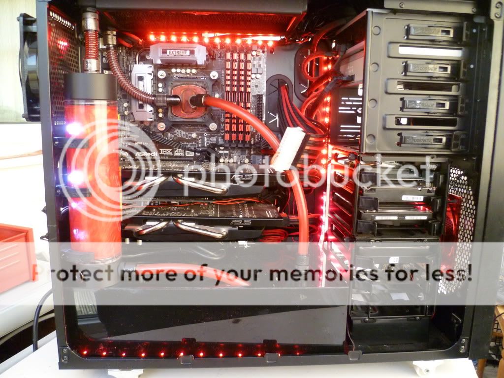

This is an old pic near the beginning of my build.

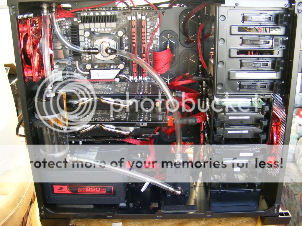

and one of how it is now.
I am wondering if it could be pump vibration on the acrylic box.
i can't imagine that loop is putting any strain on your pump, so it would be pretty pointless replacing it imo
I agree with you but my pump is making noises sort of rattling like the bearing is going, If you know what I mean that is the reason I'm asking if the it would be a good replacement. :)
wonder if its a damaged impellor maybe if you coulld d take the pump out of the system and give it a shake to see if there is anything in there rattling . you can always take the cover off i guess and check it
