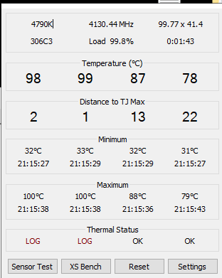

**update** he has a corsair AIO but it hits 100C during prime 95 26.6 when NOT overclocked.... any ideas / suggestions before i remove it and buy a replacement cooling solution? i only have experience in HSF.

As for that Corsair AIO, it could be any number of things at fault, I'm not a fan of AIO units. It looks like he's using the rear fan as an intake onto the rad, I think that it might be an old Corsair H40 but don't quote me on that. I wouldn't be surprised if it's an issue with the pump though given the temps described.
i've asked him to reset bios to stoc i'll report back in a bit, if anyone is interested in helping a middle-aged non techie :D
The thermal paste is converted to thick cement inside the CPU. Deliding and replacing with Kryonaut will help.
That AIO just looks like it could do with a good blast of air with the amount of dust in that case. That'll soon drop the temps. Find someone with a compressor to give that a good blowout. Guess there's no dust guards on that case.
Clean the AIO & Fan (the fan is either pulling or pushing air through the radiator in that image) and clean and re-paste the CPU.

The fan is between the radiator and the case. Is the fan actually working? But he needs to turn the radiator the other way up so the hoses are at the bottom: it's possible there's an air lock at the top of the radiator. And is the pump working?
