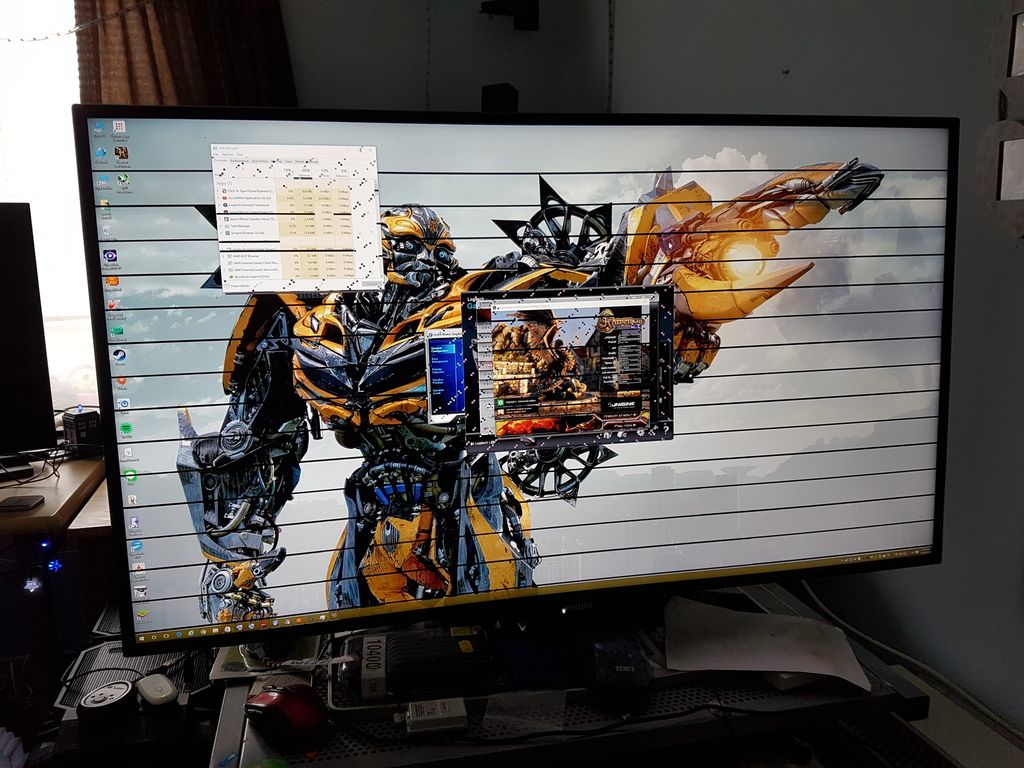

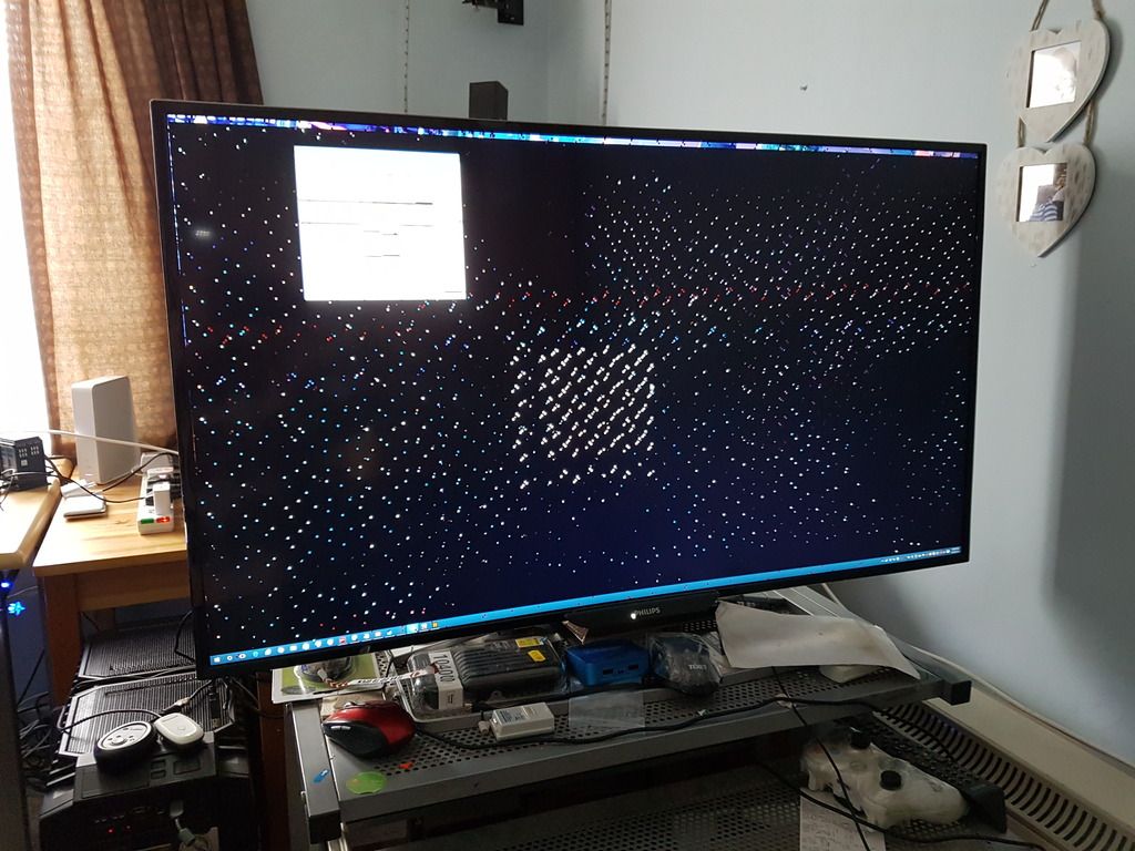

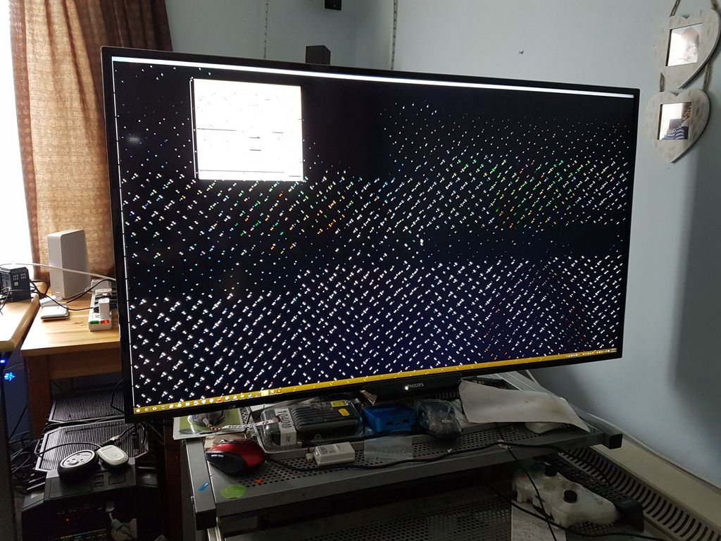

about 2 week ago I've been getting graphic issues, at first i thought it was a driver issue due to me upgrading to 16.3, so then i tried downgrading to the driver i was on before but that didn't make any difference.
it happens randomly when it's siting on the desktop, etc. and in some games such as dragon age: inquisition, Call of Duty: Black Ops III and others also..
is it worth me trying to RMA to ocuk? if so any idea how long it'll take because i don't have another card to use and what would happen as there's no more 290x.

i know it's not the DP cable as it's a new one and has been working fine,
the driver crashs when it happens.

i just tried it in a different slot but it still happens. i don't have another pc to try it in.
i reinstalled windows 10 from a image which had no graphic driver installed
Looks like it is on its way out. Try underclocking, see if it goes away. If it does, then you know the card cannot maintain the clock speed no more. Seen this happen before, so worth a try. If the case, get it replaced.

tried underclocking it to 600/700 but it still happens.
on Wednesday i borrowed another card (390x) for a short time and that works fine. so i know 100% the card is faulty.
i have a rma from ocuk so i'll be sending it back... hope it won't cost too much for P&P.
