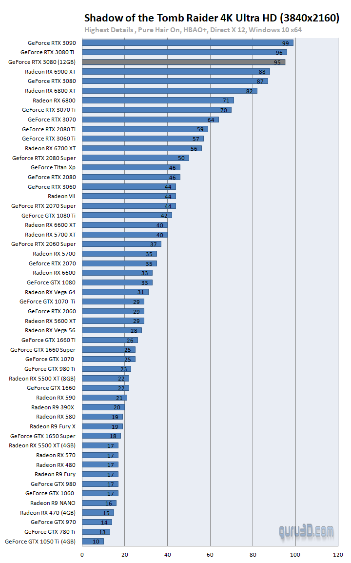

For the testing, the base clocks are not the exact same, the table you linked shows just what a "reference 3080 12GB RTX" specs are:
MSI RTX 3080 SUPRIM X
This review will focus on the flagship 3080 12G from MSI. The MSI RTX 3080 SUPRIM X boasts a massive 1890 MHz boost clock straight out of the box. That’s a rather noteworthy 180 MHz bump seen from the reference boost frequency. The SUPRIM X model also features a TDP of close to 400W which is 350W for the reference 12GB revision 3080. In return, you'll gain more performance, bringing the series very close to 3080 Ti performance levels, and even passing it every now and then. MSI equipped the card with a semi-passive design; the three fans start to spin and cool once the GPU warms up. It has a dual BIOS with gaming (perf) and silent mode. Make no mistake; both modes offer the same performance within a 1% differential; just a marginal difference in temperatures and acoustics can be perceived. SUPRIM X has been fitted with a TRI FROZR cooling solution with three TORX 4.0 fans. New in the design is that it has close quarters heat pipes around the VRM and a backplate (which is now made of metal). So that provides even better cooling. To power such large values, the cards have been equipped with 3x 8 (6+2) pins, which creates compatibility issues with some power supply cables and power supplies. Therefore, it is recommended that you have at least a 750 Watt power supply for this graphics card. At 1853g, this puppy is fairly hefty and large, measuring 336 x 140 x 61mm. You'll also receive a complimentary mouse mat and an additional stand to accommodate the card's weight if desired. It is nonetheless a thing of beauty.
Please note, we do not review a founder card ... ergo it's faster.
The GeForce RTX 3080 12GB in a reference configuration will sit in-between regular 3080 and 3080 Ti performance. Please understand that the product we review today is factory tweaked with an increase of almost 50 Watts on the power limiter and an added 180 MHz. As such this card performance is NOT comparable towards reference performance, often this 12GB SKU passes the 3080 Ti and sometimes in CPU limited resolutions even the RTX 3090. Again; this article does not show reference performance as Nvidia did not release a founder edition card, capiche? Alright then. Please proceed to the next page.
So are you saying increasing overall specs of a card won't provide any benefit to perf. either? In that case, better tell nvidia to not bother increasing memeory bandwitch etc. then :D
Given the significantly higher boost clock etc., this is a bad comparison but an easy way to solve and prove that there is more to the card gaining the extra perf. than just "extra 2GB VRAM"... lets look at games where total amount of vram is not an issue for the measly 10gb 3080:
And eteknix review where it shows the 3080 12GB being a better performer across all games (where vram amount is a non-issue):
So to conclude, boost clock and better specs "overall" is why you're seeing somewhat of an increase in perf.

The full review is here https://www.guru3d.com/articles_summary/msi_geforce_rtx_3080_suprim_x_12gb_review.html , the card used was a MSI Suprim X that can use 450w when overclocked too. It's an OC 3080 12GB so no surprise it beats a stock 3080ti FE in some cases, at 4k the 3080ti beats it in most cases even not oced.
I can believe it, I get around 156 fps in the SOTTR benchmark @1440p with my 3080FE but if I overclock the memory + core and max out the power limit it jumps to 170fps which is a 9% boost over stock and only just under what a stock 3080ti FE would give so it's not supprising a top of the line factory OC 3080 12gb beats the standard 3080ti FE.
