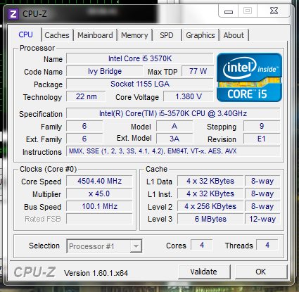

I left it on Auto
That's 100% the problem as i once had it on auto and temps were all over the place ! Try setting volts around 1.28 and going lower until unstable . Or like others have mention use CPU z to tell you. But if it was me I'd just set it at 1.28 and work my self down. That's what I did and settled for 1.25.
This is CPU-z
And yeah I will go set it to 1.28 and then do tests, and work my way down until its not stable.
This is CPU-z
Yeah, auto mode normally overestimates the voltage necessary, as demonstrated here, because 1.38v is unnecessarily high for 4.5 GHz. If you are using offset voltage (which I would advise to keep idle temps and power consumption lower) then try a negative offset of 0.1 and see if it is stable.

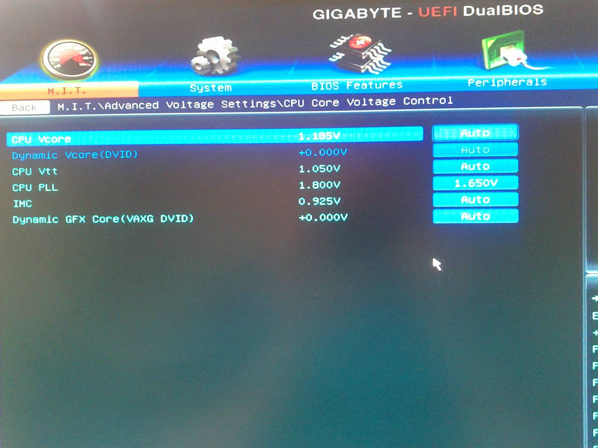

What do I change here:
To do that?
To do that?
Ty for every ones help, its really refreshing.
I'm not familiar with Gigabytes BIOS, but look at how to enable offset voltage, it is normally enabled at default anyway, but if you want to see if you are using it, see if your volts drop when under no load. Fixed voltage will keep volts constant, even if Speedstep reduces the frequency at idle. Offset will allow the motherboard to deliver lower voltage when at idle or low loads, which helps to save power and heat. I would recommend using speedstep (which should be enabled at default), even though many people like to keep their CPU running at max frequency all the time, I don't see the point in wasting power and causing unnecessary amounts of heat at idle.
Enable offset mode if you aren't already using it, and then find out how to set a negative/positive offset from the instructions. Try a negative offset of 0.1v, this will effectively mean that the motherboard will subtract 0.1v from whatever Vcore it would have send automatically- in your case 1.38v at load, which 1.28v should suffice. It will of course also subtract this from your idle Vcore, so you should get slightly better idle temps (though the difference won't be as pronounced as the load temp difference) After that, run a stress test, such as Prime95 for about 6 hours, and check your Vcore, you should see it peaking at 1.28v instead of 1.38v. Hopefully you will be stable, in which case you could increase the negative offset to get even lower Vcore (and thus lower temps). If you aren't stable, then decrease the negative offset in increments, (0.095v, 0.090v etc) which will raise the Vcore from 1.28v in increments. Keep doing this until you are stable.
