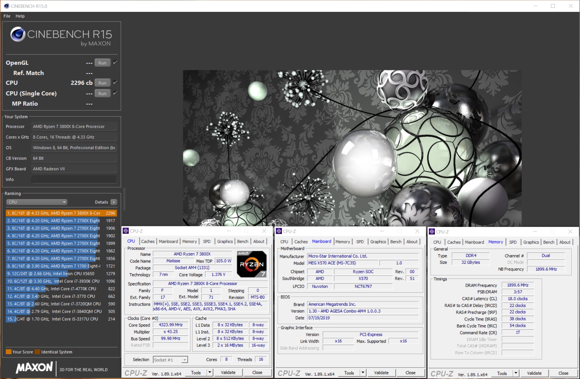

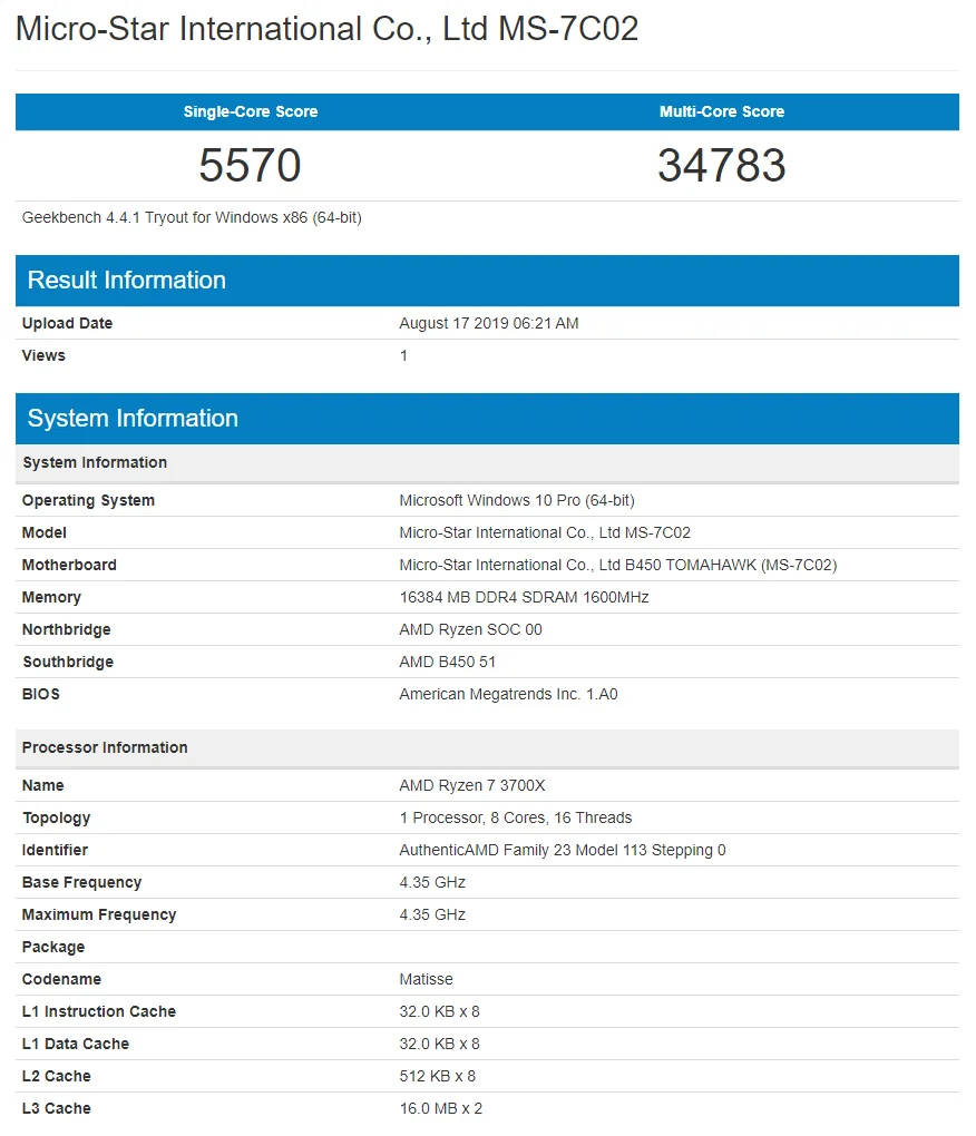

After somne testing using Ryzen Master, ive set my bios to 43.50, 1.37v. Seems the 1.0.0.3ab bios is stopoping my chip from hitting 4.4 single thread so decided to go with an All core OC but dont want to push the volts too much.

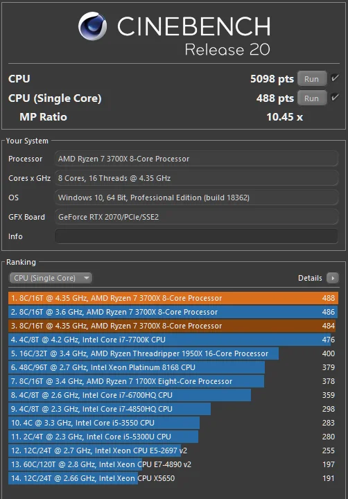

Looks like a very good chip although your R20 score seems low for that overclock.
Try running it with high priority in the task manager.
The screen might freeze while it's running but that's normal.

Nice, under heavy stress, make sure its drooping to around about 1.325v, level 5 on my MSI board for CPU LLC setting, you can test it by opening CPU-z and running something like IBT AVX. https://www.techspot.com/downloads/4965-intelburntest.html
Strange CPU's these 3000 series are though, the clock wall is pretty easy to find when overclocking these, I tried 4.4ghz first....no stable, down to 4.35ghz.........not stable.........down to 4.325ghz, runs stress tests all day long.

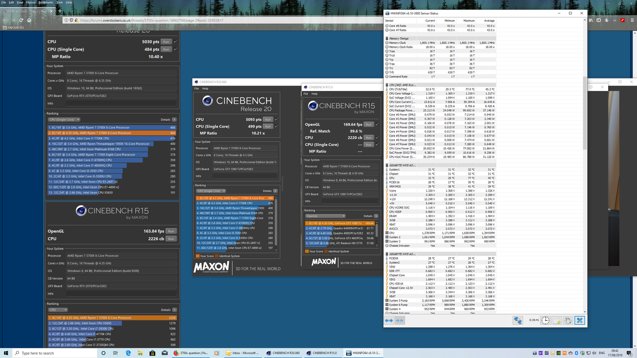

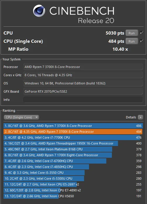

Re ran R2.0 but killed a few background tasks and my hardware moniitors, also set the memory CMD rate from 2T too 1T and set windows to use the Ryzen High Performance plan. Got a slight boost:
