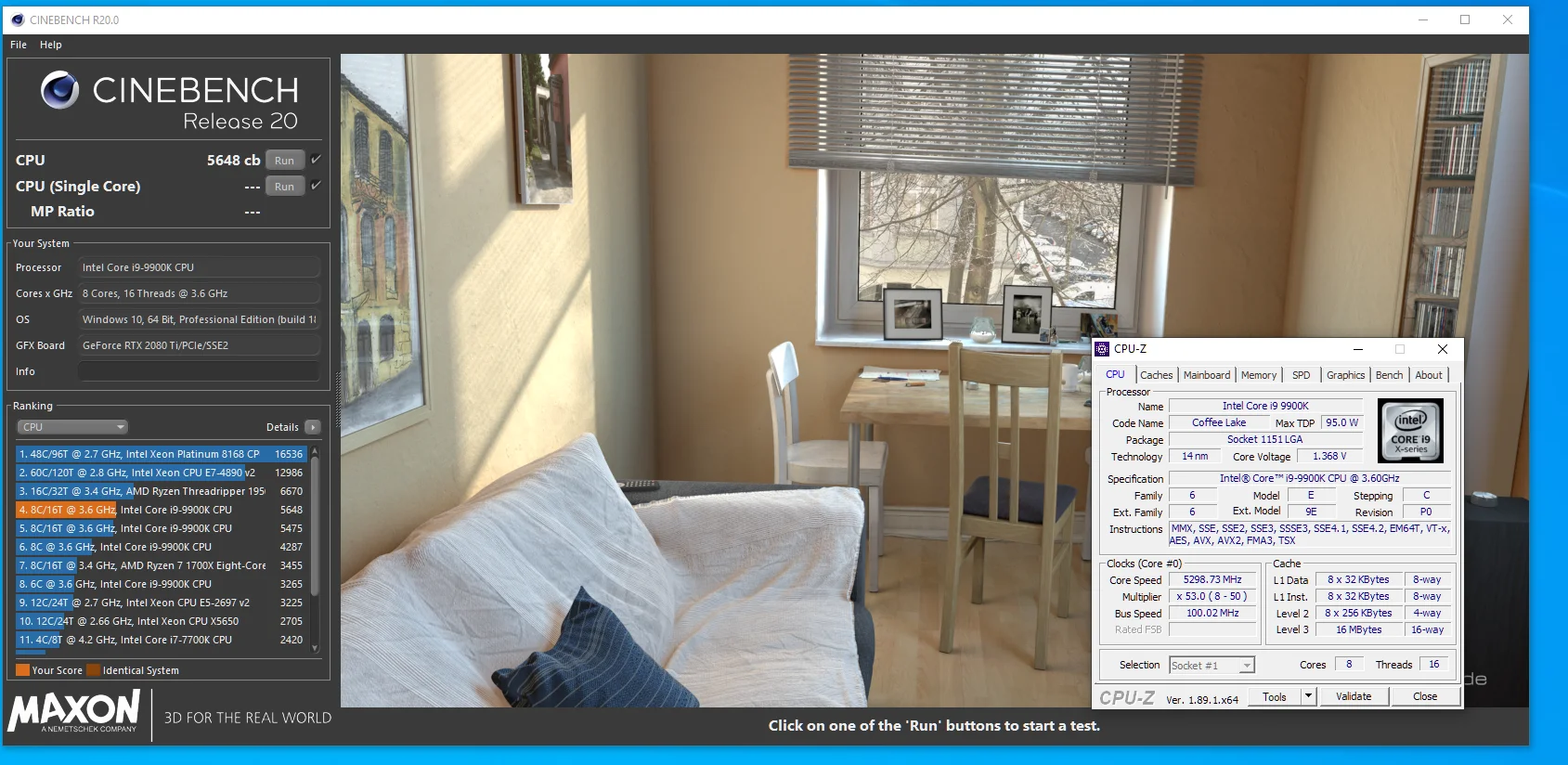

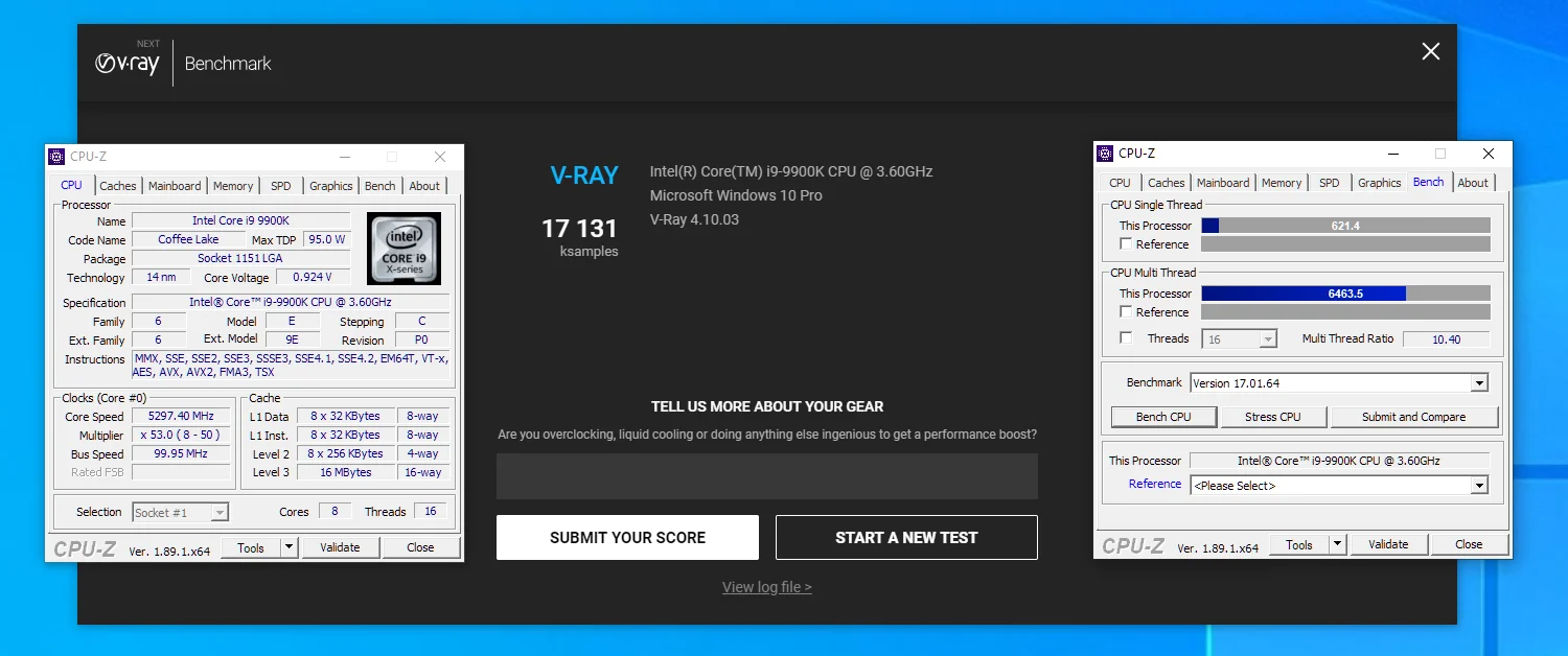

5.3ghz benchmarks. A lot of the KS units should be able to do this or close.
CPU-Z and V RAY:
R20:
CPU-Z and V RAY:
R20:
5.3GHz all cores, most won't reach that or won't be able to cool it. 9900k/kf/ks its all about cooling, people can bench for awhile but the temps are too high. If you have 5.3GHz on a 9900k rejoice, as very very few people will also have that type of overclock. It's very rare. Most people will get 5.1GHz all cores on the 9900ks and a few will hit 5.2GHz but 5.3GHz will be very rare. People run AVX offsets to keep things cool.
