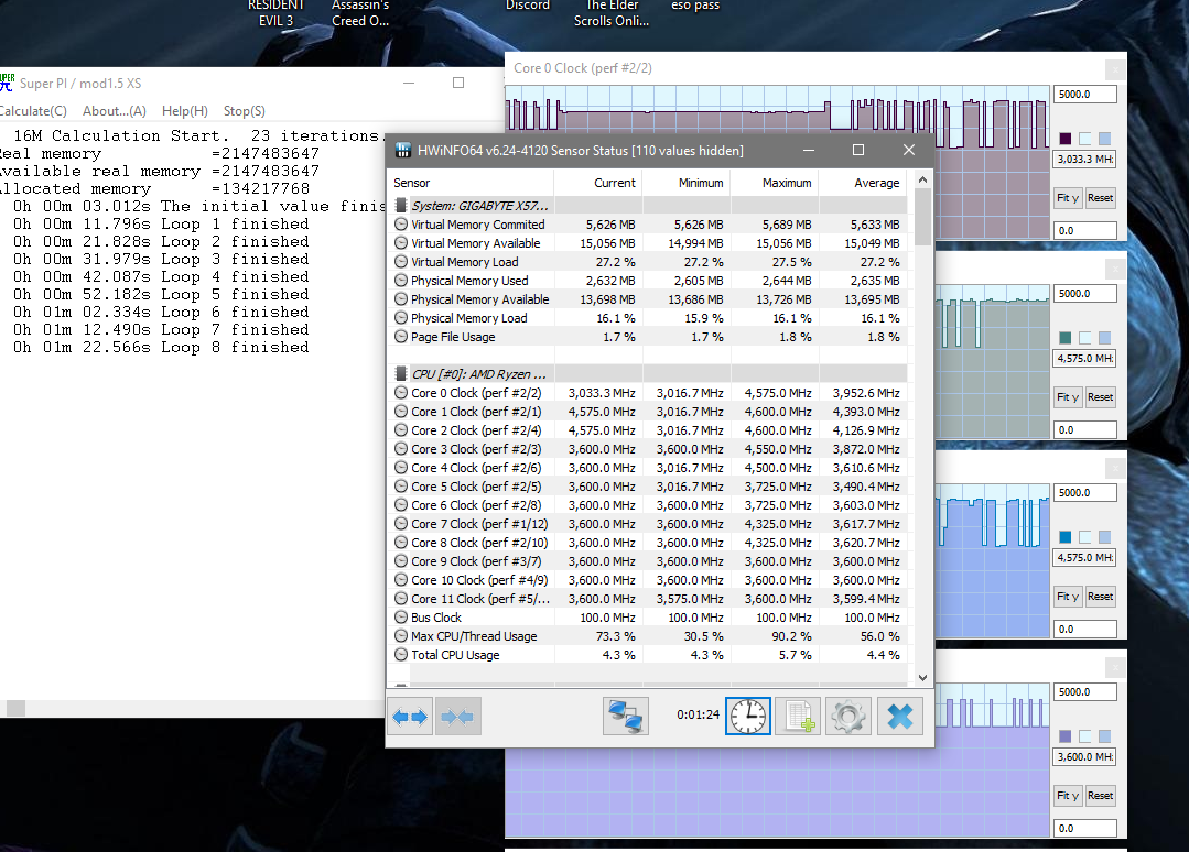

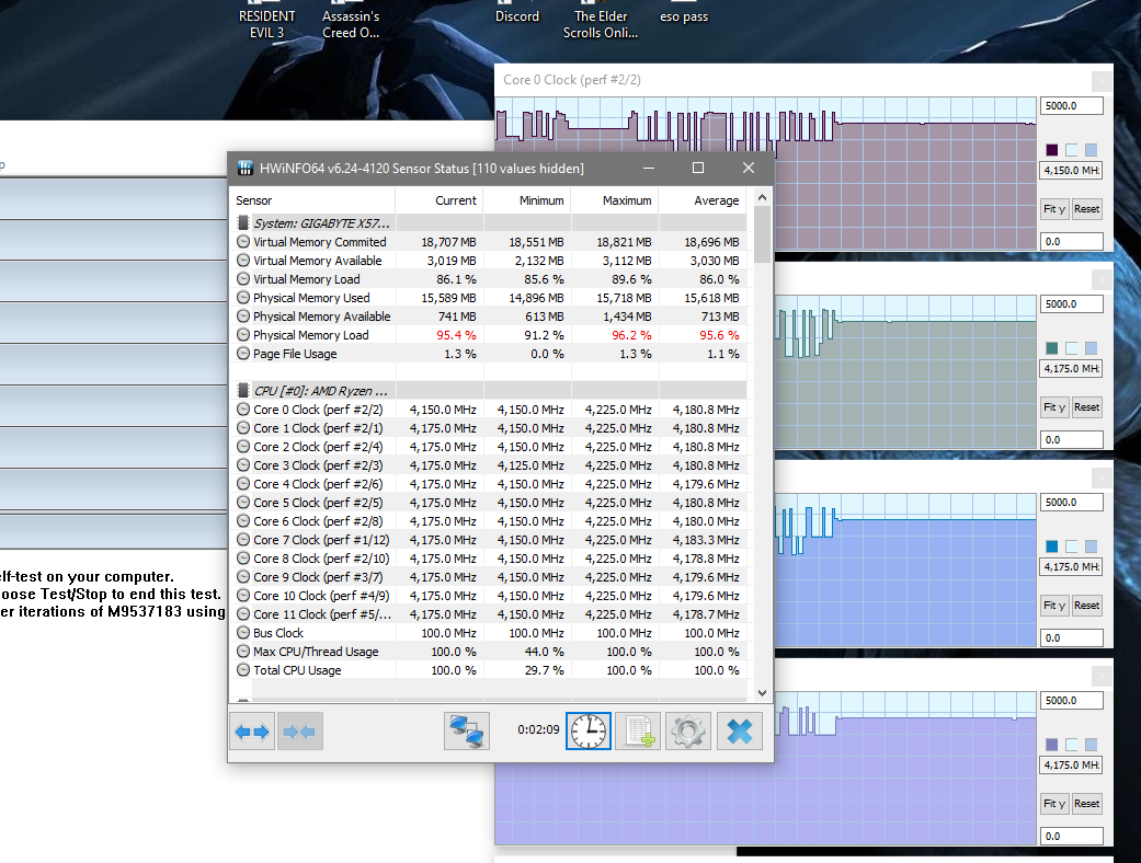

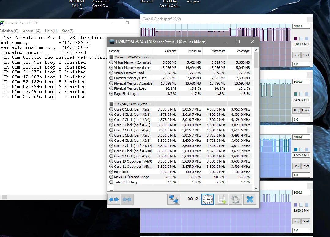

Did some tests with Panos' suggested Community v3 power plan / PBO auto
Not sure how scientific they are :D
Single core boost 4.6 GHz
Prime Blend high load test 4.225 GHZ
Random gaming load 4.35 GHz
Super Pi low load 4.6 GHz
