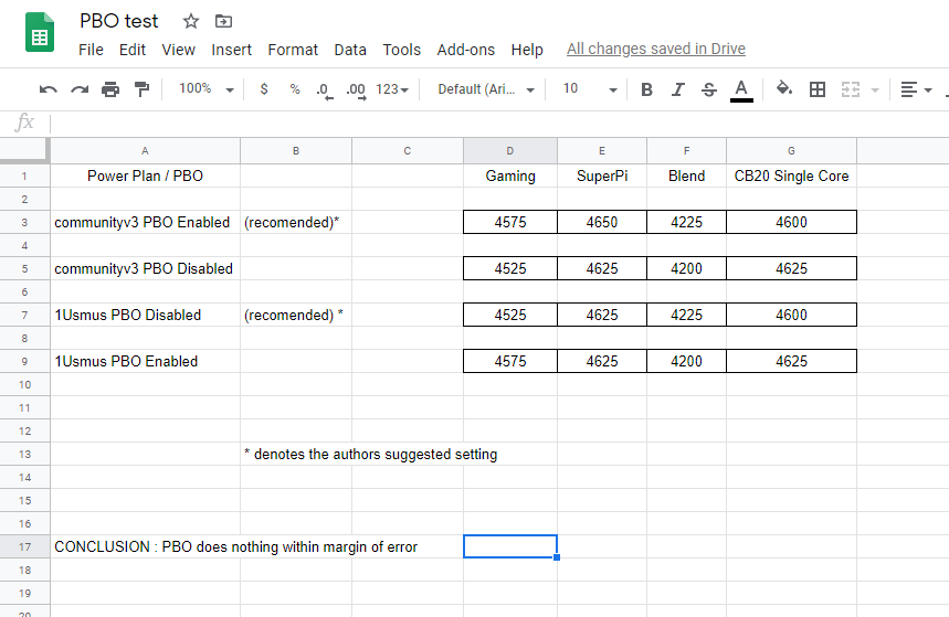

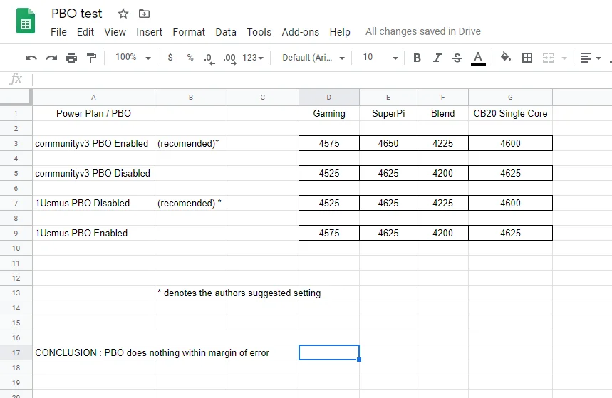

Did some testing of PBO today.
Various loads : Gaming / Super Pi / Prime Blend / CB20 Single Core
Peak/Boost speed measured by HWInfo
Within margin of error on my part - It does nothing.
25mhz i conside margin of error / 0.5% in mhz
Biggest difference of 50mhz in gaming could be down to the inconsistancy of load in a non consistant environment, still only approx 1% variance in mhz
That's normal. Have a read of reddit you'll see tons of people saying pbo does nothing, tons of people saying pbo is slower than stock and another ton of people like pianos who says it's the best thing since alices bread. The only conclusion is that everyone has different quality cpu and the only gauranteed performance is the one you get when the cpu is stock out of the box
