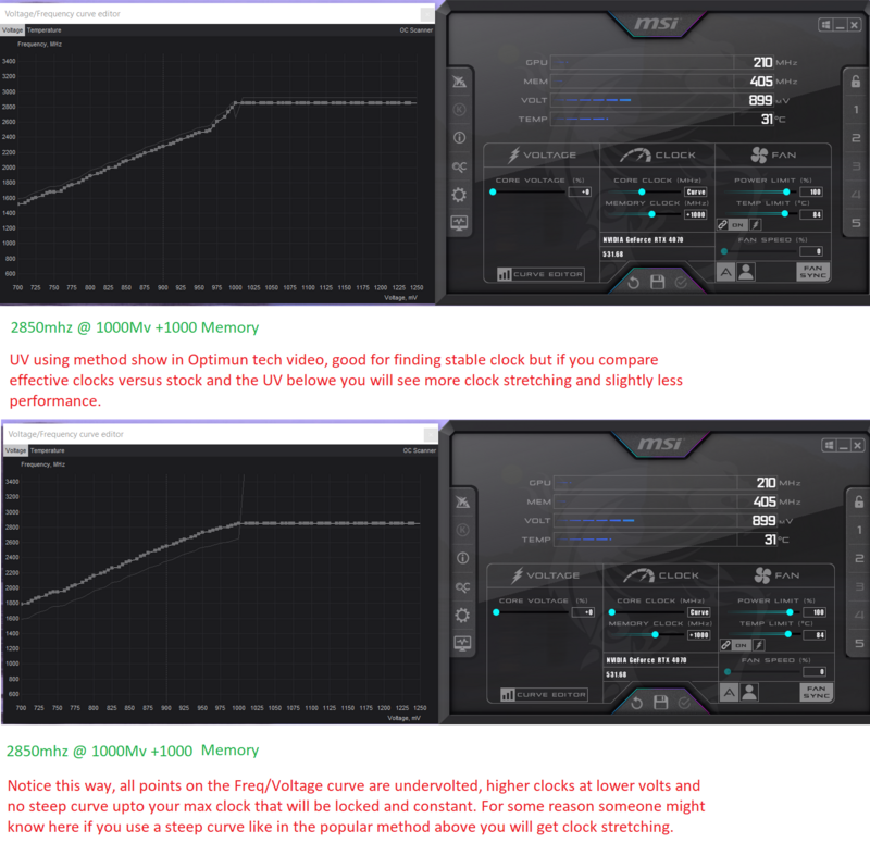

So normal method used is this to produce Pic 1:
Used this for years but found out recently that its not ideal and there is a better way to get less clock stretching and better performance.
So rather than doing this, what you want to do is (pic 2) ***EDIT FOUND THE VIDEO, credit to this guy and his guide, couldn't find earlier:
1. open up Afterburner and open curve editor
2.Find the voltage you wish to use, I will use 1000Mv, Hold left mouse button and to the left (on curve editor) you will see the clock speed at that voltage, for me its 2655mhz
3.I want 2850mhz @ 1000Mv so add the difference into Core Clock box on main Afterburner GUI, so add +195 and hit enter.
4.Now Hold Shift and select anywhere on the curve editor in between 1000 and 1010Mv but not on the node and drag the big box to the far right.
5.Release Shift then select any node in the highlighted box after 1000mv and pull down past 2850mhz and press enter and it will flatten the curve after 2850mhz
I know this isn't new to some but a lot of people using the old method but this way is better.

Thnx for this. I'm going to give this a go when I come home from work tonight.
