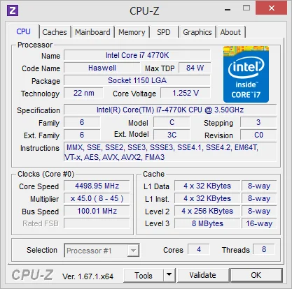

I am trying to overclock my 4770K Haswell to a half decent clock whilst remaining stable.
I'm currently at 4.5Ghz with Core Voltage at 1.25 but it keeps giving the BSOD after a few minutes running OCCT or Prime95. I've had a quick look at the log file and the offending file seems to be ntoskrnl.exe and nvlddmkm.sys.
I didn't even think going to 4.5 would be such a strain for it. It's starting to get extremely annoying now.
Thanks in advance.
More Vcore man!!!
Some Haswell cant do 4.5ghz stable for torture tests. Give it 1.275v and use the PC instead of synthetic testing.
Really?! I swear I read somewhere that anything over 1.25 will make it an unhappy chip. Maybe that's BS then :p
Will knock it up to 1.275 and report back.

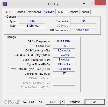

Do I need to make any changes to my memory at all? I read some people have fiddled with XMP. Is that recommended?

Set XMP with RAM that's fine for starters. Try uncore at 4.2 and test again once CPU is fine.

Doing well at 4.5 with 1.275 at the moment.

Cheers buddy. Everything has seemed spot on for gaming at 4.5 now - nice and stable. My GPU still needs some time spent on it but I doubt I'll get much out of it as it's the MSI 770 Gaming Edition and I don't think it's meant for overclocking much.
