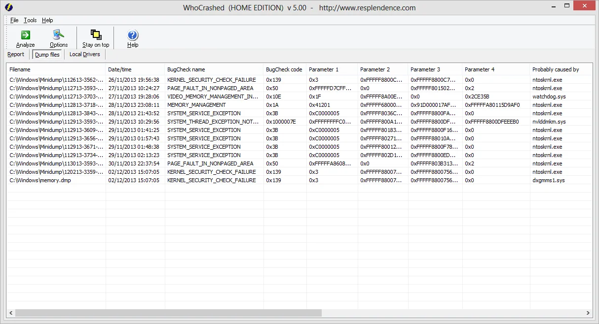

Just used WhoCrashed and got this...
On Mon 02/12/2013 15:07:05 GMT your computer crashed
crash dump file: C:\Windows\Minidump\120213-3359-01.dmp
This was probably caused by the following module: ntoskrnl.exe (nt+0x5A440)
Bugcheck code: 0x139 (0x3, 0xFFFFF88007567590, 0xFFFFF880075674E8, 0x0)
Error: KERNEL_SECURITY_CHECK_FAILURE
file path: C:\Windows\system32\ntoskrnl.exe
product: Microsoft® Windows® Operating System
company: Microsoft Corporation
description: NT Kernel & System
Bug check description: The kernel has detected the corruption of a critical data structure.
The crash took place in the Windows kernel. Possibly this problem is caused by another driver that cannot be identified at this time.
As you can see from the screenshot below, this ntoskrnl.exe thing seems to be a common issue for me. You can also see how frequently I'm BSOD'ing.

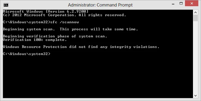

Run "sfc /scannow" to see if the integrity of the system files is okay.
I learned something quite useful yesterday. If you want to know which driver is causing the BSOD, run "verifier.exe /standard /all" and reboot. The next time it BSODs, boot into safe mode and run "verifier.exe /reset" and then boot back to Windows.
Afterwards, use WinDBG and the symbols to find out which driver is fubar. This gave me a lot more useful info than a normal minidump or even full memory dump.
Everything looks fine on this front.
