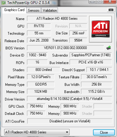

O_O thats odd "defult clocks 750Mhz" I only get 500 :S

Sounds like it's showing 2D clocks, what happens when you minimize a game and load up GPUZ?
haven't treid that yet. I will try that now acturly not that hard, its still sohwing 750 clock but the acutral seems a little down I mean what the hell :o

thats better thanks :) it now shows the currect value
