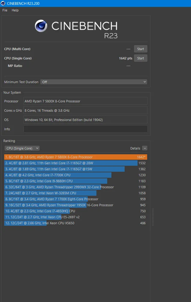

The score on R23 multi was 22,872 and Single 1580. Nothing special

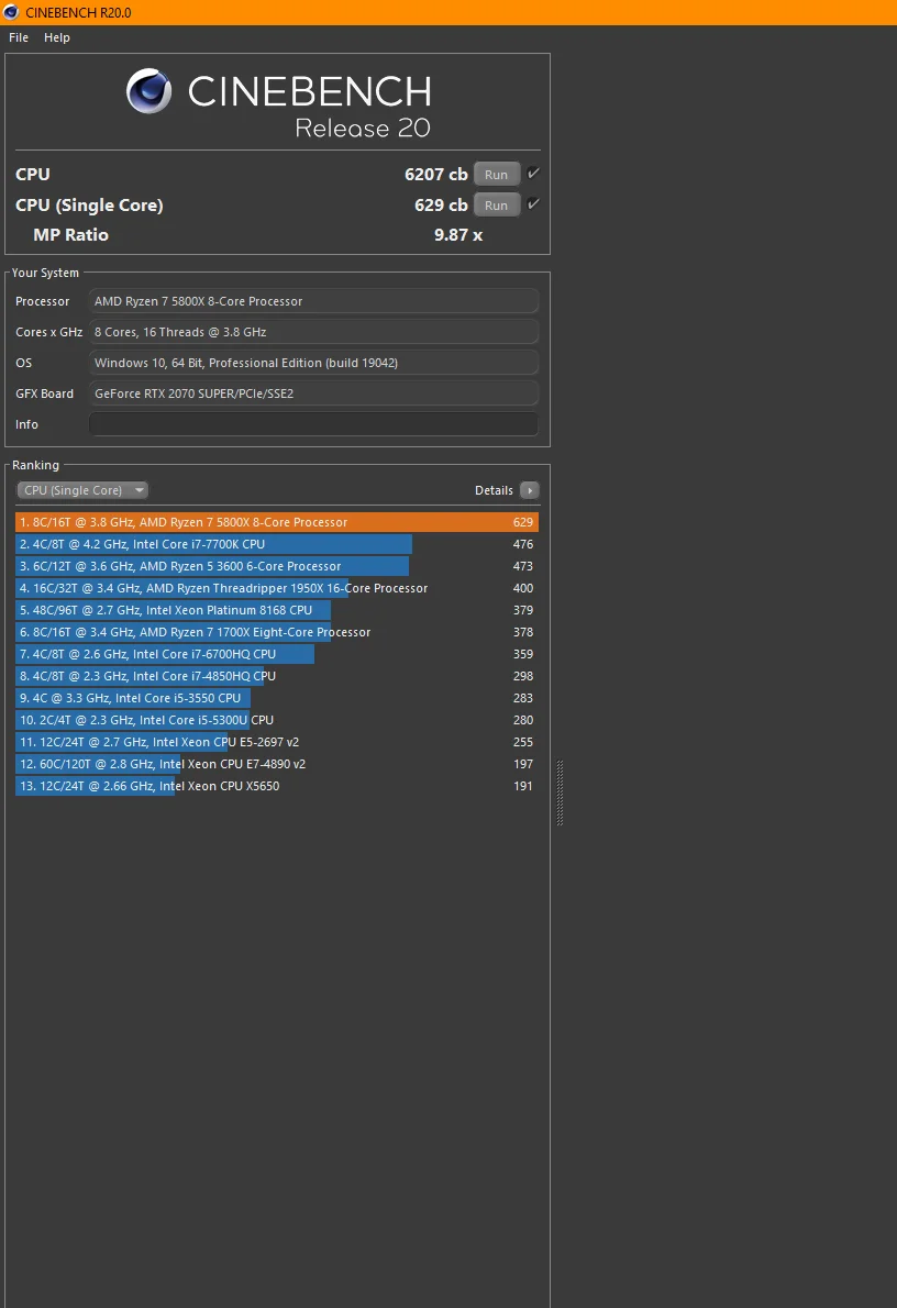

my 5800X managed to boot and under load with CO -30 on all cores but i only found the WHEA errors by using Prime95 Large FFT with no AVX and set affinity to individual cores and let it run for like 20min at a time then will the WHEA error show up.

Dropped the override down to -0.1250. I have done a full R23 run multi and single. Previous was with a 50 Mhz boost. 21682, 1561, Multi Core boost 4,650

Yes 1561 is a single core score. Basically I just have C0, PBO Disabled, LLC and a negative offset. Default single core boost is 4950.2, The chips doing its thing given how cool its running along with my custom loop. I'm assuming

I got my 5600x running with a -30 on CO and a -0.05 offset with LLC at level 1 with no errors. It maxes out at 65C die temp and 1.13v SV12 TFN with prime 95 max stress and sits at 4650mhz under load. I finally got a decent chip after years of mediocre ones.

Just having a play. Reduced the offset to -0.1625 and applied a 200 MHz boost. Currently running R23 single thread and it’s boosting up to 5,100.
played with enabling PBO and that’s worth about another 1500 points on R23 multi but adds about 13’c extra heat and 50 watts extra power.
